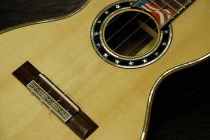

I haven't posted anything in awhile, so for whatever it's worth, this came out of the shop a month ago. It's a concert uke with a little more bling than most people here like. Top: red spruce Back/sides/fretboard/head overlay: EIR Neck: mahogany Bridge: cocobolo Binding: koa Purfling: gold MOP/bwb Inlays: white and gold MOP/ebony/dyed veneers Tuners: Gotoh It's braced similarly to a classical guitar with 5 fan braces, the outer 2 of which extend into the neck block. The neck is dovetailed and the head is attached with a "V" joint. The back is "X" braced and 2 upper ladder braces. Craig S.

That's beautiful.  Nicely done theme, without overloading it.  I'm no bling fan, but I don't think this has too much, it is so nicely done.  Great job.

Nice One Craig.
You do know, now it's common practice to post YouTube videos showing off your work audibly!
Good to see you, this is a sweet looking machine, what chops you have!

Fantastic work Craig! Would love to hear this one. Never heard of an Adi top on a Uke. Bet it can really sing.

Very nice work.    CAn we get a close-up of your back strip?

Sorry for taking so long to respond, but the lockdown slowed me down. Thanks for the kind words. Ricardo, I don't have a pic of the back center strip, but it's the same as the tie block on the bridge. Tracy, although it sounds great to me, I can't say it sounds any better than any other decent uke I've ever heard. There's just never enough energy generated in a uke to create as much sustain as in a guitar. I'm no uke player (you can interpret that as "plunk-a-plunk-a-plunk"), so I'd really like to hear it in the hands of a real player. Jake, maybe? Now on to a gold/black walnut banjo and a pau rosa/Englemann jumbo. :geek:

Hey...where did the pictures go? Gorgeous work Craig.
