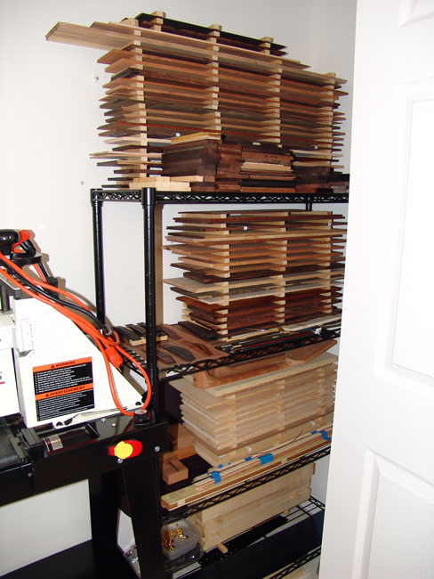

Old timers in the sawmill business would sometimes store their lumber on end, leaning against  a rafter at about a 5 to 10 degree angle to dry. Surprisingly, these green boards would dry flat, without cupping or warpage. Although most modern sawyers use the stack and sticker method to dry their wood, some still dry it using this leaning method.
I have wondered how dried woods that have been prepared for guitar building would do if stored on end, with a slight lean also. I have cut several billets of mahogany that I am trying this on and will know more in a year or so if it works, or not.
My issues with stickering is that it seems that I always want the sets that are on the bottom of the stack and this disrupts the whole stack when I pull out the one on bottom. Chris's method certainly solves that issue.

I store my sets stickered for 6 months to a year then they get stacked. I suppose I would leave them stickered, but I just don't have room. When I am ready to use a set I will pull them out and let them get used to the shop for a few days. Then I surface and join them. Sides I will get right to bending from flat stacks (if I ever was in that much of a rush, which is never the case).

Rick not a daft question at all my friend.  When I started I had the same question.
Stickering refers to stacking the wood with "stickers" or spacers in between the various pieces to encourage air flow.  Stickers can be many things so long as what ever you use does not stain the wood, is flat, and supports the weight of the stack - cheap helps too.  It's also using the wood to weight itself down when in a stack as pictured below.
I write the date and what ever it is on each set.  But...... a label that could be read from the side of the stack would be very welcome here....

Stickering is not necessary after the wood is dried and stabilized to your shop conditions. Stacking on a flat surface will prevent or minimize warping.
