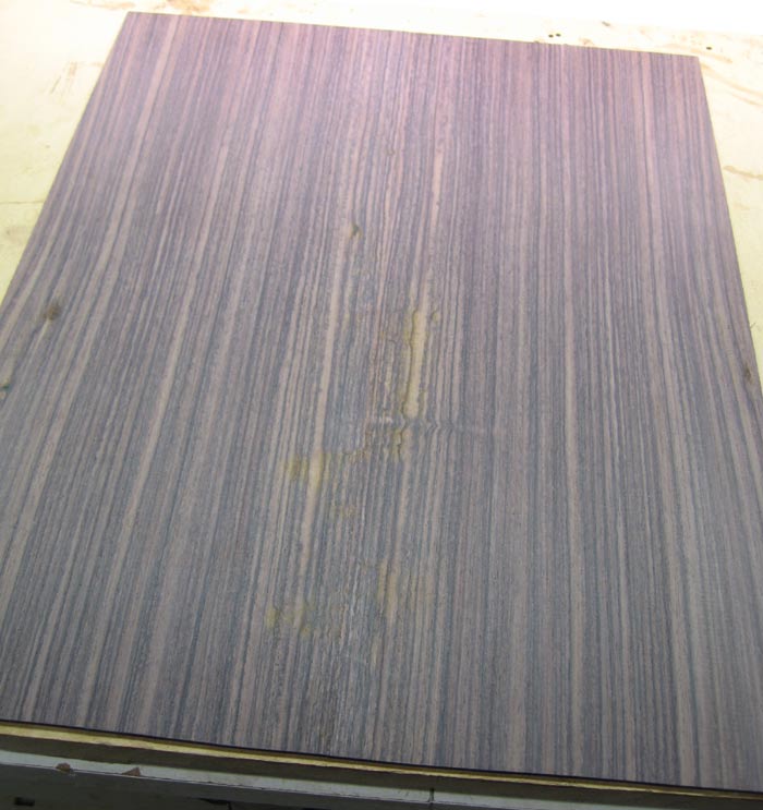

I have this set of Indian rosewood which has a beautiful glassy tap tone but has this awful discoloration right in the center:
It looks even worse under a wipe of shellac. In the past I have thought about gilding a guitar in silver or copper leaf and applying a chemical patination to explore different textures and colors than wood allows. This seems a great opportunity to try it and use a great sounding but aesthetically unacceptable wood. Has anyone heard of someone doing this? Can you think of a reason why I shouldn't?

I can't really see the discoloration in the photo, but If you don't like it I would just paint or shade it. I don't know about gilding though. Harpsichord trim and picture frames do alright, but on a guitar back I would be concerned with how gracefully it would weather and wear. Back and sides of a guitar may be a high traffic area for gold leaf.

You mean the yellowish spots, they seem to be common on IRW. How about doing a bit of FP over it see how it looks. I think under finish it could look much better.
Under a wipe of shellac they look pretty awful.

Oh well, sorry it didn't work. But read this thread. In the end they sent me a different set without yellow patches so I have no follow up

I use an oil-based pore filler that I tint with oil-based stain. It doesn't take anything away from the wood grain, in fact it enhances it. It also greatly evens out the colors. This would probably greatly reduce the problem. Sanding will also help.

I used minwax brand Brazilian Rosewood gel stain on my last guitar. It was a set of opportunity grade EIR from Allied. The stain worked beautifully and really made the wood pop. I say go with stain...although a gilded guitar would be interesting.

I like the staining idea, and would certainly try that before either gilding, or in frustration throwing it away.
In fact, you could try wiping it down with acetone, which will pick up the oils in the wood surrounding that spot, and move them all over the piece. That will be tricky if you use a light colored seam inlay, but do-able without one. Or, could you trim out that section, and perhaps fit in a center piece for a three piece back?

Thanks for the suggestions, but I'm really more interested in potential reasons why I shouldn't gild than ways to cover up the stain. I think I am going to go for it; if it turns out badly I can always scrape the gilding off and start fresh...
