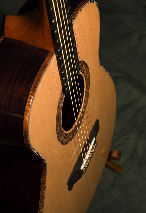

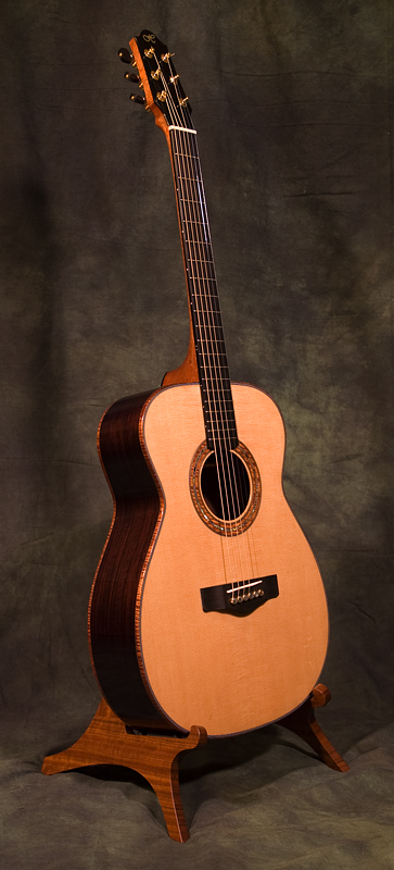

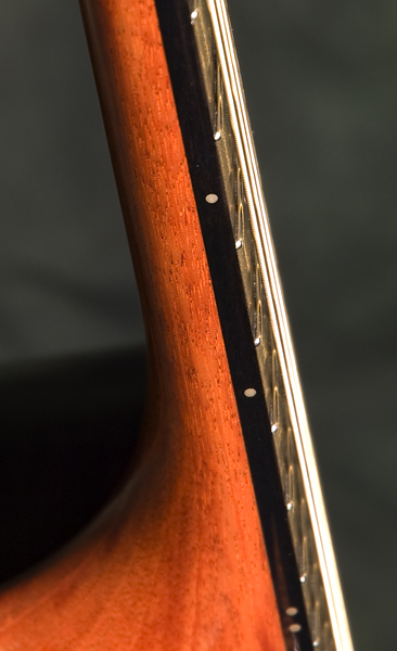

Hello Everyone,
My first commissioned build will be delivered this Saturday. Parting is such sweet sorrow!
Here are some pics taken by my talented wife!
Thanks for looking!
- Ric

Nice job Ric ! where is kings park ? jody
PostPosted: Wed May 21, 2008 5:27 pm
That looks pretty sweet Ric!!

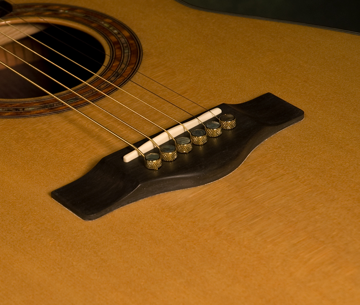

I can't think of another I have seen with steel (brass/bronze?) bridge pins. Obviously you like them?
Great job

That's a beauty, and your wife certainly knows how to show it at it's best. I only have reservations about 2 things. The volute seems a little strange and I'd like it better with wooden bridge pins.

Cool... I love the wood combo.

Sweet guitar! Where did the bridge pins come from? I like the look. Congrats on the next step!

Very nice and clean work Ric and it looks like an excellent guitar that I am sure that the new owner will love!
The pics are great too, kudos to your wife too.

Shane, Chansen: The bridge pins are Carraco's EZ-Pegs and I love em! These are solid bradd and have abalone inlay.

Exceptional work Ric!

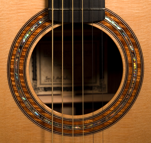

The rosettes is STUNNING!
Im sure your customer will be pleased! [clap]

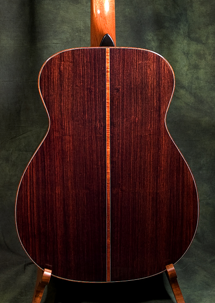

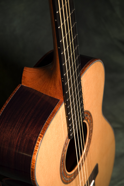

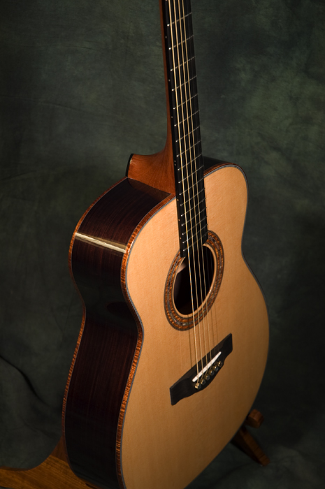

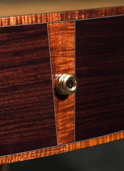

Now in critique mode, two things that I did notice is the side purfling at the end graft and back purfling at center seam is not mitered. Next time out the gate mitering these joints will really make the end graft and back purfling joints pop and add to the craftsmanship. The other is work on the butt joint of the binding. You go a bit of a gap not bad but noticeable to the discriminating buyer. You might give scarf joint there a try for a near seamless look.
I too am not real hot on the Brass pins. Bone or wood would look much more classic but that is just a personal opinion

Michael,
Thanks for the input. I am planning on mitering the purf joints for the next one as well as tweaking the binding joints. Things seem to move so fast when gluing up the binding! As far as the bridge pins go, I do like them and am getting favorable feedback from folks who see my guitars. My next build will be very similar to this one and the customer wants the brass/abalone pins. As you stated, this is clearly open to personal opinion, and also easily swapped with any other bridge pin as the hole is still your standard 3/16".

Michael,
I forgot to mention that actually there's no gap on the binding. What happened is that the ends got slightly burned a bit when I trued up the ends using the disc on my stationary belt sander. Next time I'll need to be sure and use a fresh disc before starting that process.

Very tasteful! I like that rosette too! Great photos!

I am really impressed with the wood choices, the rosette and the general execution. I am not a brass pin lover but those look nice. I am wondering how the increased mass of those pins, when compared with wood, affect the tone of the guitar. It would be an interesting experiment to try some wood pins and see what difference that makes.

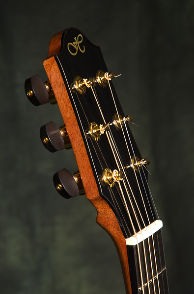

Excellent! I like the look of the dark contrasting heal cap. Great photos too! Also Ric... I really like your logo/inlay!

With regard to the sound differencebetween brass pegs vs. wood... I think that would be an interesting test and I'll definately do that at some point. When I do, I will post my findings.
