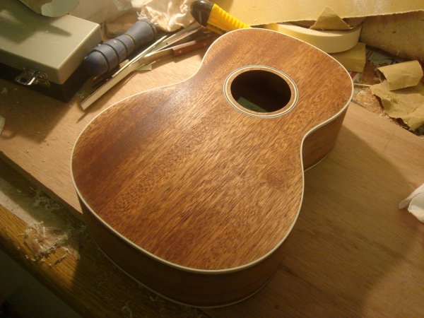

I had some very similar with a uke I recently built. See the paler area on the left of the lower front....
In fact there were other more pale areas around too....
Then when I started the finishing that area just seemed to soak in the finish and not stop getting darker and darker. And that was with shellac! It just wouldn't polish up. I ended up making a satin finish of it. It had all the attributes of end grain.
Rod
