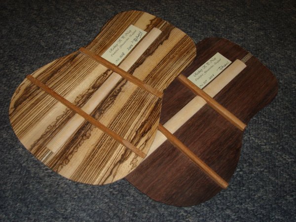

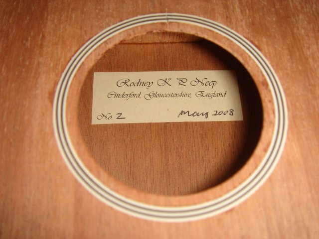

I think simple is good....
This one was done with Microsoft Word, printed several up per sheet of buff coloured paper. I just cut one off the sheet when I need one, and glue it down with whatever glue I am using for the instrument.
Some ukuleles...
Oh yes... and I have a "pet hate".... labels that state "Custom Made" on all instruments that people make. A custom really is only applicable when it is made to order for a specific individual, and then the label may say "Custom made for.... "
Rod
