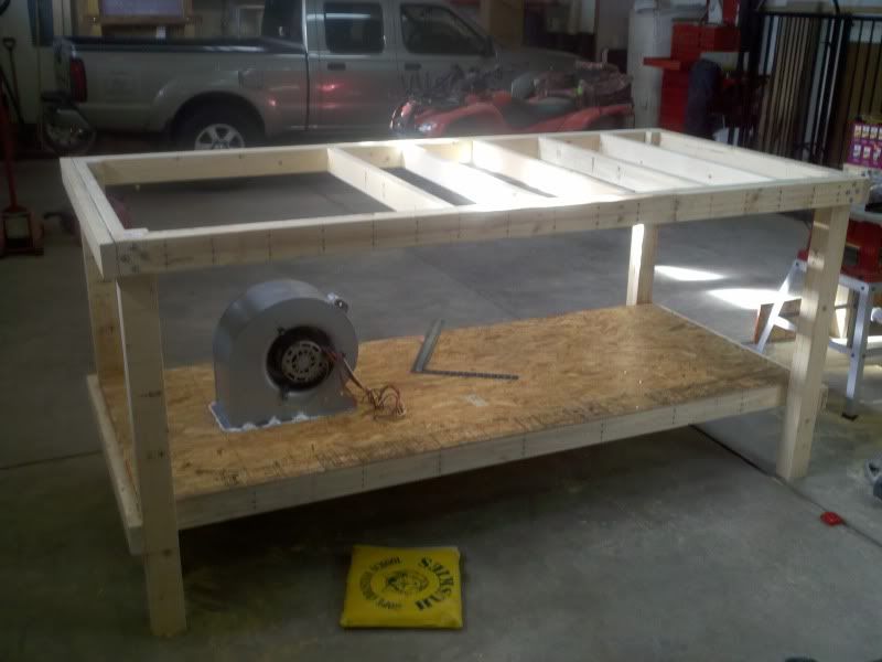

Hi Guys,
Well the dust and coughing finally became too much, I got the idea for
this from you guys here !! Thanks !!
Dimensions are 4' X 8' X 46" (I'm 6'4" and like a tall work bench)
Starting the basic frame,
Fan installation, its a 110V, 4 spd, 1/3hp, 1075rpm, approx 1100cfm purchased on ebay.
Building the box around the fan,
All seams have been sealed with a bead silicone to prevent any "leakage"
Rotary switch, purchased on ebay
Hood and filter, my primary work area is going to be in front of the hood,
I wanted the hood to help direct air flow, it works very well.
The filter was the best that lowes had in stock,
I'm thinking the filter is not the place to skimp.
Total cost as you see it was just under $300
Gregg

Looks good Gregg! Does the fan vent out the bottom of your bench then?

Shane,
Yes it vents out the bottom.
Gregg
Gregg

I made one that consists of holes drilled into my bench top, going to my cheap harbor freight dust remover, which does not seem to have enough sucking power, but it kind of works. The problem seems to be my bag doesn't filter really fine dust and I've been coughing up a storm lately. I don't quite understand how that filter works on yours.

Nick,
The filter is 24" X 30", The filter has a 1" border around the parameter, a cardboard frame,
filtering area is 22" X 28", under the filter is a 22" X 28" square hole cut into the top of the bench.
This hole is sized to allow that 1" cardboard frame border to be siliconed to the top of the bench.
The fan is mounted to the lower shelf as you can see in picture #4, there is a hole cut in the
bottom of the shelf matching the outlet of the fan, turning on the fan forces huge amounts
of air to be sucked through the filter into the airbox through the fan and exhausted out the bottom.
I purchased the filter at lowes, its a furnance filter. They had a chart showing all the filters and there
filtering ability including allergens, dust particle size...ect
I just bought the filter at the top of the list, $20
Works like a charm !!
Gregg

Nice job Gregg. I like your design.
I built one recently and it really cleaned up my shop. For filters I use three progressively finer pleated filters topped with tow of the cheap fiber furnace filters. The finer filter is only required to handle the very small particles. The initial purchase is greater but the service life is extended enough to compensate for the additional cost and you don"t have to clean the filters as often. The blower you have has enough air flow the handle the additional restriction without any problem.
Another use for a table of this type is as a downdraft spray booth base. Enclose three sides and replace your filters with a three or four fiber furnace filter stack and over spray is eliminated. It is a life saver if you are like me and don't have space for a dedicated spray booth.
Cecil

[:Y:] Nice design Gregg , One of the few things we can build where "it sucks" is a compliment ! laughing6-hehe
PostPosted: Tue Feb 01, 2011 9:36 am
Posts: 1310
Location: Michigan,U.S.A.
Nice looking unit Gregg. Is it pretty quiet?

Mark,
The noise is not bad at all,
The few time I've used it I kept it on Medium speed,
I can hear the radio just fine.
Gregg

That looks very nice. I have a squirrel cage unit on my shop floor right now. You have inspired me to do something with it. My only problem is stealing the time away from my guitar builds :D
For those, like me - cheap, I have this hanging in my shop. The idea came from a woodworking magazine somewhere. It is a box fan with a filter on the intake side of the unit. It was designed for the floor but when hung from the floor joist it works well. I have mine wired to a timer switch so that it shuts off on its own. It is not a Jet but more like a Cessna (you would build yourself of course).
Oh, one note when hanging this, use a rubber bushing of some sort at the contact point with the joist. If not, it creates a hum upstairs that can get irritating over time.
