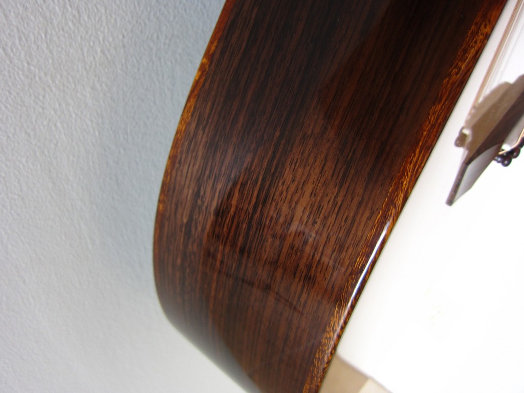

It's an OM, made from the OLF plans. Back and sides are EIR, neck is mahogany. Fingerboard, bridge, headstock veneer, and binding is all Arizona Desert Ironwood. Zipflex purfling, top and back. Top is Sitka spruce. Gold tuners, gold "Evo" fretwire. Bracing is considerably slimmer than the plans called for. ;) It sounds awesome. [:Y:]
I used the Sherwin Williams Lacquer for this one, and I'm not real happy with it. Probably won't be selling this one for that reason. Too bad. I guess I'll have to keep it. :mrgreen:

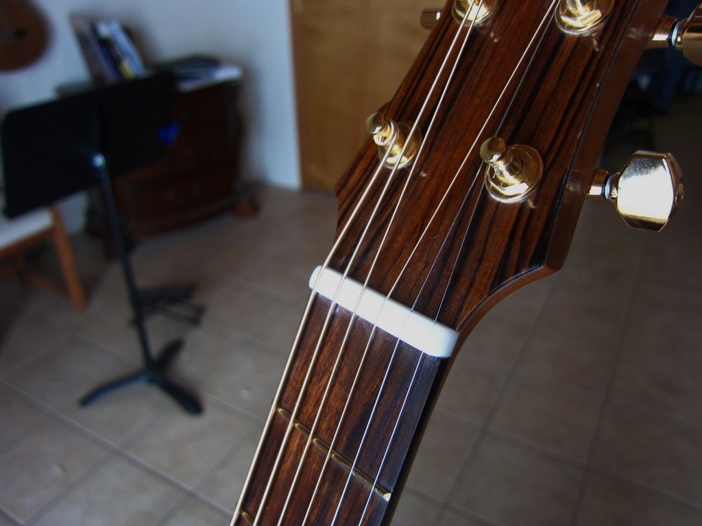

Very nice!
You might consider one little tweak, the nut, it would look a little more refined if you tapered the tuner side with a nice soft slope.
Just a thought is all.
Other wise, excellent!

These pictures were taken before the nut was finished. It's now sloped and rounded and comfy. :D
I'll take another picture of it.

The nut:

Looks nice! For tapering the nut as Lance suggested, there is a good example in the first picture on the following link:
http://frets.com/FRETSPages/Musician/Ge ... nuts1.html
He also has info on making the nut:
http://frets.com/FRETSPages/Luthier/Tec ... wnut1.html
There are other many articles as well....a good source of information!

Beautiful guitar! Congrats. I didn't see anything with the finish? What didn't you like? Clinton

From the pix the finish looks fine...(?)

The thing I don't like about the finish is, it seems brittle, (I dropped a wooden caul on the top and put a chip in it) but it's also soft enough to take impressions (when I clamped the fingerboard extension on to glue it, the cork covered caul marred the lacquer on the back). Maybe it's just not cured all the way, I don't know. But I think I'll save the rest of my S-W lacquer for cheaper instruments like psalteries, and use the good stuff for guitars.

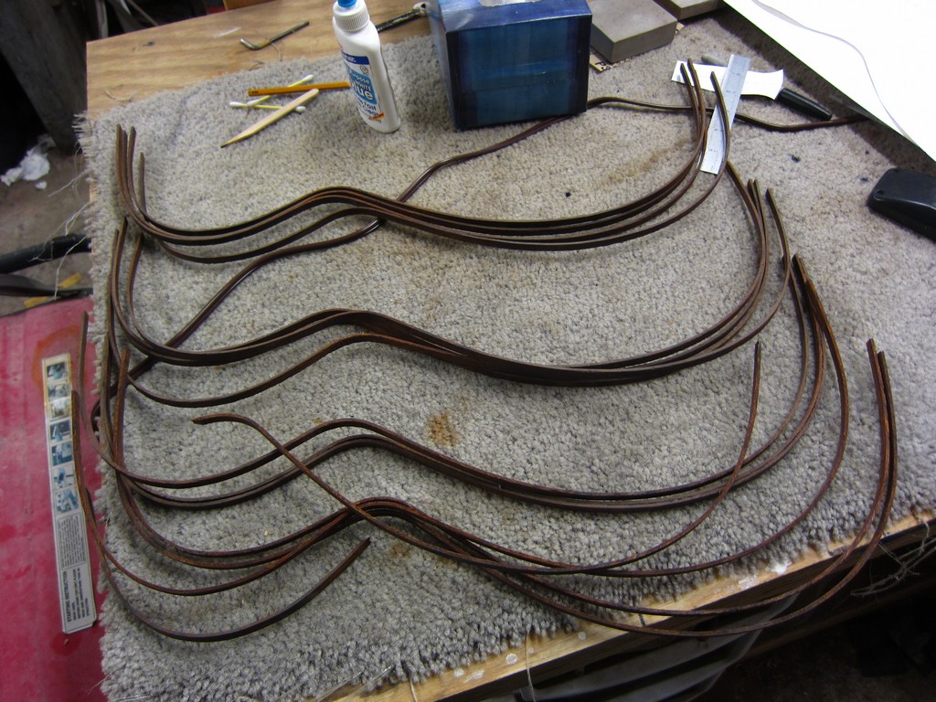

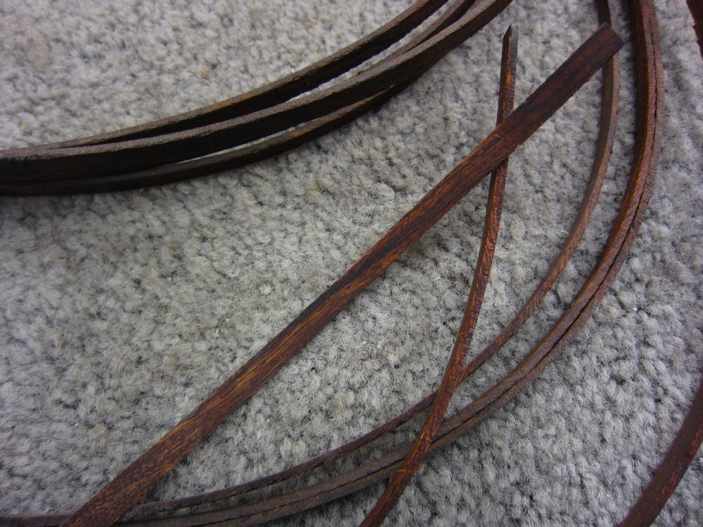

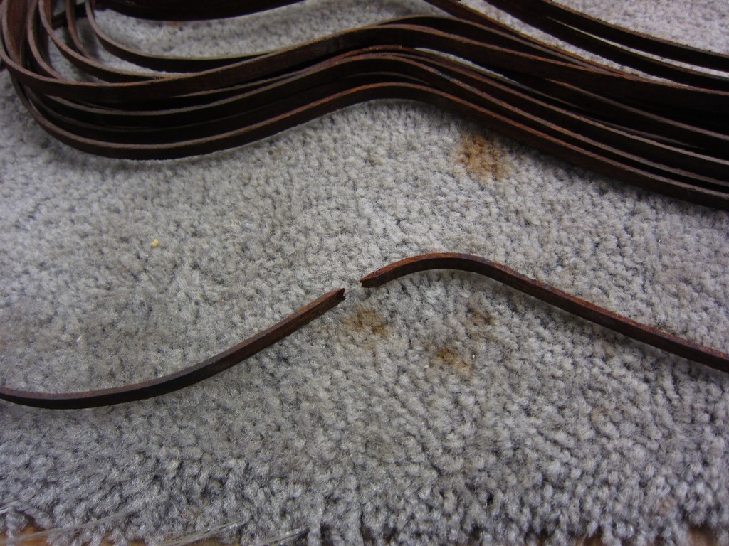

Congrats! I'd like to see some of that ironwood. I've got some and believe it to be very prone to crack (brittle, rogue grain, etc.) Though I've only sawn it into bindings and haven't bent them yet.
Can you post a few pix of the binding, and share your experience with bending the ironwood? I'd appreciate that. Thanks.
Here's a shot of some of my bindings. Top one sealed in shellac, couple dark areas are (obvious) saw burn marks:

Hi Terry,
Here's some more pics:
I have enough bindings bent for 3 more guitars. Like you mentioned, this stuff is prone to breaking. One of the pieces I used on this guitar broke, but I glued it together with CA, and now I can't find where it broke. So it's not necessarily a fatal thing...
