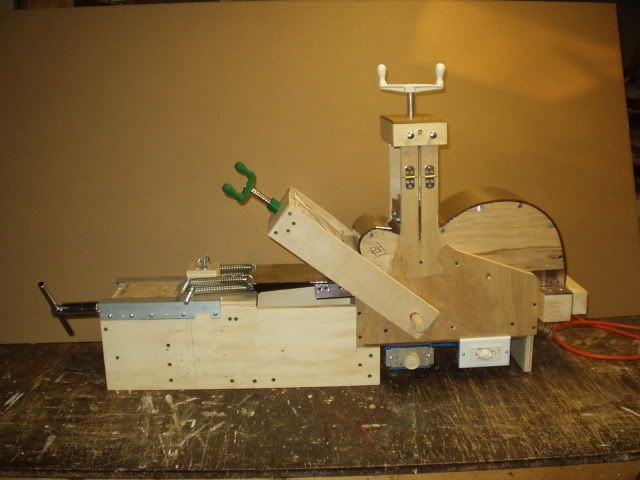

Terrence the cutaway bender works a little different, there is a sandwich so to speak but all the parts (blanket, and two .008 SS shim stock slats) are attached to the machine, the pre-cut pre-profiled side is simply loaded and the LB end clamped. In addition to the upper blanket the form itself is also internally heated. The slat are fastened to an adjustable tensioning system which is tightened or loosened as the compression caul/s are moved along the profile. This is a refined redesign of a unit I once saw on YouTube. The device must be fastened to the bench. The system is proprietary so this is all that can be posted -- thank you for understanding.
Ken Cierp
These users thanked the author kencierp for the post (total 2): Pmaj7 (Thu Apr 09, 2015 2:50 pm) • Terence Kennedy (Thu Apr 09, 2015 11:08 am)

Here's where I first saw the inspiration for our cutaway bender
https://www.youtube.com/watch?v=y1K-PgNmhj8
Ken Cierp
These users thanked the author kencierp for the post: Terence Kennedy (Thu Apr 09, 2015 11:08 am)
Didn't they show that pic in the film 50 shades of grey? ;)
Very nice Ken! [:Y:]
These users thanked the author Hesh for the post (total 2): Terence Kennedy (Fri Apr 10, 2015 12:34 pm) • CharlieT (Thu Apr 09, 2015 8:28 pm)
