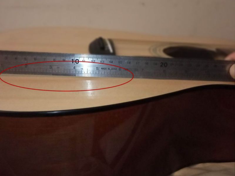

I also bought a beginner acoustic guitar, about 5 months now. I bought brand new. I just noticed that the guitar top is not flat. I can feel the bulge with my hand but better if I show you photos
look from side, I press ruler flat towards the neck

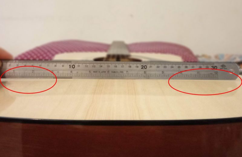

look from bottom to neck, ruler balance in the middle
Because it is not old guitar, I am surprised why the top is like that. The strings have not been changed before and are original from factory.
Can anyone please explain if this is normal for new guitars? If it is not normal, what are the likely reasons for this phenomenon? Is it defective?

It’s normal.

what your are seeing is the top pulling from lack of RH control. This time of year things get dry so get a sound hole humidifier if the guitar gets too dry the top will split.
flat tops are not flat by the way this is a reference to the arch top comparison

Acoustic guitars are often called "flattops" even though the tops are not flat. The guitar is made with a radius (curved surface) in the top and back. Different brands and different builders use different radii for their guitars, but all guitars have them.
In addition to the built-in radius, the top will also develop a bit of extra curve when string tension is added. This is called the "load" and is normal unless it becomes excessive. 2-3 degrees of bridge rotation is considered normal.

Yes, the simple answer to the original post is that that amount of arch is quite normal for the top of an acoustic guitar.
As other people have mentioned the humidity in the air can cause that arch to change from day to day. This is also OK, as long as it does not become too extreme. It happens because wood naturally absorbs water from moist air and swells, or looses moisture into dry air and shrinks. If you have ever noticed the wood windows or doors or drawers in your house getting jammed tight in wet weather it is the same thing. Guitar soundboards experience a lot of humidity flux because they have a huge surface area exposed to the air, relative to their mass.
