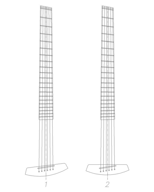

I fancy building an OM size multiscale guitar, just for fun. I only build instruments for fun, for me, or for one or two family members or friends. I've built a couple of multiscale (electric) bass guitars but no acoustics.
From what I've seen, people who do build them rotate the bridge more or less, depending on where the 'perpendicular' fret is, as shown in drawing No1. This means that the top bracing has to be rotated also, or moved off-centre, particularly in the case of X-bracing so that the ends of the bridge are supported by the X.

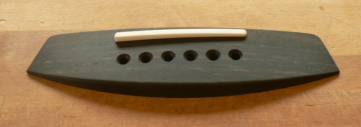

But what if I rotated the saddle and pin holes (as in No1 but left the body of the bridge perpendicular to the centre line, as in No2? That way I could leave the bracing symetrical, in its usual position. The bridge would be more or less like the one in the photo. What do you think?

Just by looks I'd go for number 1. And it says multiscale. Number 2 looks bulky.

I would rotate the bracing to land bridge wings on X brace legs. No change in sound, I have done this many times and the results are great.

13-fret OOO. Regular bridge in the standard position, nut rotated. Works good if scale difference is not too big. Scale is 25.4 and 25.15, copied, with permission, from Bruce Sexaur.

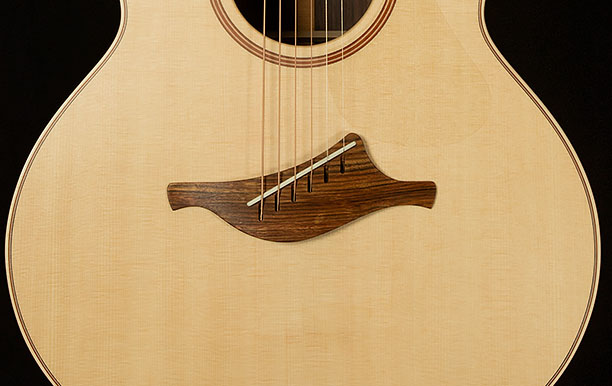

More than one way to keep the bracing symmetrical.

It's strange, the bridge does look a little more bulky in No2, but it's exactly the same profile as No1, rotated round the centre of the radius on the treble end of the saddle.
Are you sure the bracing is symmetrical in those two guitars Colin? I'd say that a symmetrical X-brace that goes just under the treble end of the bridges is going to miss the bass end.
And I would agree with your statement, but also say that a symmetrical X-brace that goes just under the bass end of the bridges is going to go under the treble end, no?

Either way is fine with such a small saddle angle. Personally I prefer 7th fret perpendicular, which gives more angle to deal with. I use a combination of bridge twist and bracing modification.
I don't like the Somogyi style bridge in Colin's post above. The square wings draw too much attention, like it's a regular bridge which has been twisted. I prefer shapes that have an S curve to them, but look like they're meant to be that way to begin with. These two also have asymmetrical body shapes, which I think looks more natural with fan frets. And it makes the armrest bevel look elegant (if you notice it at all), whereas they look awful to my eye when cutting into an otherwise symmetrical body shape.

Of course Colin. I'd just got it into my head that the X-brace is supposed to go under the ends of the bridge. So if the bridge is revolved, the X-brace has to be revolved or moved south to keep it under the bass end, which might not be desirable. After all, people make 13-fret guitars in order to move the bridge (and X-brace) north, looking for the 'sweet spot'.

Having said all of that I do like the looks of #1 and if it was my project I wouldn't be worried about shifting the bracing to make it work since it wouldn't move much.

By the way, talk about bulky, this is bulky!

Yes, always thought the Lowden fan fret bridge design was a poor design choice.
