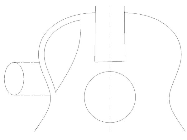

I'm drawing up plans for an OM sized guitar with a sound hole in the bass side upper bout. (Don't ask!)
For various reasons to do with the rest of the construction, whatever shape I make the sound hole, it can't be as big as the conventional round hole would be.
So I thought that adding a sound port in the side, of a size which when added to the size of my unconventional sound hole is the equivalent of the conventional one, might be the answer.
This sounds logical to me - does it to anyone else?
I don't seem to recall people saying that when they add a sound port, they reduce the diameter of the sound hole.
Complicated answers involving Helmholtz and main air resonances or whatever, may tend to go over my head. Just saying ;)

It might look something like this.
The upper left sound hole and the ellptical sound port are the equivalent area of the round hole.

Due to the proximity, I'd say the hole+port will function more like a single hole than usual. Sort of like a large hole with a bar through the middle of it. Perhaps even better if you make the port a half circle, with the flat side as close to the soundboard as you can get without structural issues. John How posted a photo of a guitar-in-progress on the AGF back in 2010 that has fascinated me ever since, which was styled to look like a violin, with the spaces left by the C-bouts in the soundboard becoming soundholes for the guitar-shaped body, and the bass side one wrapping down into the side as well. Not sure if he ever finished it, but someday I would like to build one like it.

The sound hole in the upper bout in the corner will indeed tend to bring up the bass. The 'main air' resonance tends to drop in pitch as the hole is moved from the center of the top out toward the end, assuming the hole is the same size. A smaller hole will drop the 'air' pitch even further. There is other stuff going on with 'air' resonances up in the corner as well that will alter the timbre of the guitar, Finally, from what I can tell, the 'normal' sound hole position works in ways that are fairly complicated to increase the 'complexity' of the sound, which is why it has been retained for so long as a feature of guitar design.
Opening a 'port' in the side will raise the 'air' pitch and make it stronger. This usually comes across as being 'less bassy', or maybe more 'forward' or 'open' sounding. The combination of the hole in the corner and a port could well end up placing the 'air' resonance pretty close to it's usual spot, at about G on the low E string. The main utility of a port is as a 'monitor', and it doesn't need to be too big for that. If the port and the corner sound hole have about the same total area as a normal round hole the 'air' pitch might well work out pretty nicely; the usual range is somewhere between F# and A, so you've got a pretty big target to aim for.
