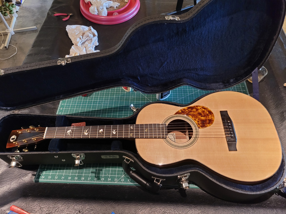

Martin Style 0 body - 12 fret - short scale
Sitka/Hawaiian Koa
Mahogany Neck
Ebano bindings
Ebony Fretboard and Headstock veneer
Ebony Bridge
System 3 Silvertip pore fill
Post-cat Royal Lac sprayed finish.
video (sorry for single channel)

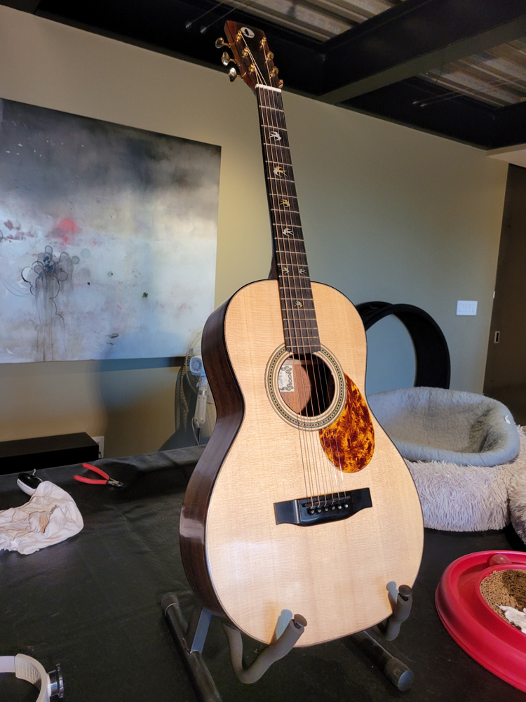

Excellent work, John. Love the fret markers!

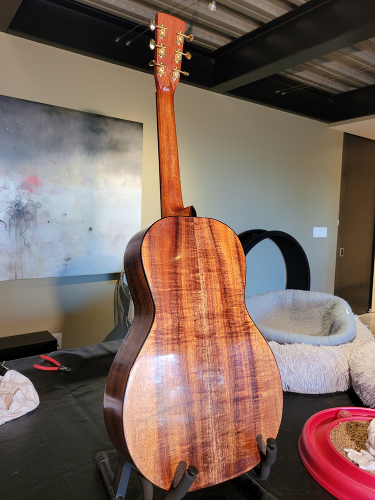

Beautiful! Man, I love Koa.

Beautiful--what about the pickguard? It's pretty too.

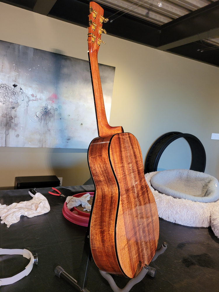

meddlingfool wrote:
Sweet! How’d the Royal lac go for you?
Thanks, I find it easy to spray level coats. I spray 4 coats 2 hours apart, lightly dry sand with 600p the next morning and repeat. After the last day of spraying I wait a week and wet sand. This is the 2 part post cat Royal Lac. I like the look.
Dave
Thanks, The pickguard is one of my few remaining tor-tis pickguards. I am not sure they are even made any more.
