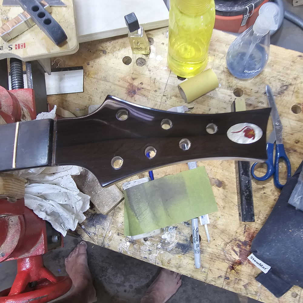

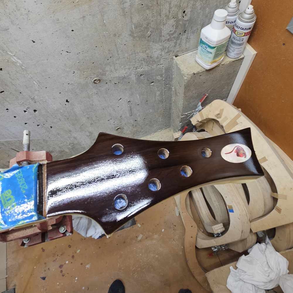

I used it for a headstock veneer. It worked and looked just like they advertised. The nozzle on the can sprayed an amazingly clean, even and leveled coat. I sprayed 10 coats about every 10 minutes. I level sanded and buffed it a few days latter.
Off the gun one coat
Off the gun 10 or so coats
level and buffed
