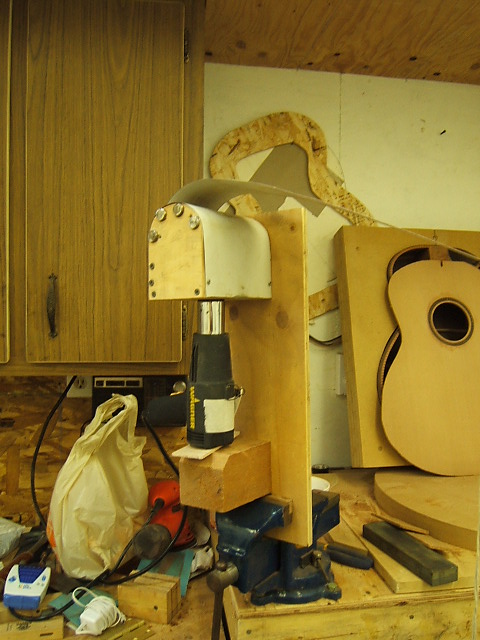

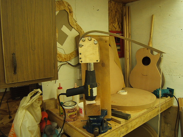

Also, I bend the entire side before I cut the cutaway part off, than bent it backwards in my cutaway bender.
This will help too I think.
Here is the bender.
As you can see I use a heat gun for the heat source, this thing works great, do the binding at the same time.

Whats the white material on the bender?

J, the white is just aluminum flashing I used for the slats.
