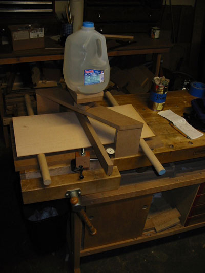

My deflection jig is a table with 2 dowels mounted at 18" on center. A dial indicator jig can be referenced on the top and zeroed. A given weight is applied and the top is sanded until a given deflection is acheived.
My deflection was acheived by using a "template" top that we made in ES's class. Considering what you use for a weight your target deflection will differ from other builders, but if you always use the same weight as a reference point you will have a consistant longitudinal stiffness on the plate.

I haven't taken taken Ervins class although I think it would be great. But I do test most of my wood and do top deflection on a ficture very similar to what Brock describes. I test both direction though and just rotate the dowells and indicator for the second direction.
Here's a picture of my rig. There's a 1/4 inch steel rod that actually comes in contact with the top.
It doesn't show up very well but there's a base plate with slots cut into it for the dowells to sit in.

It sounds as if you're seeking a specific amount of deflection across a span of fixed distance with a given weight. Do you compensate for different body sizes?

No. The goal is to pretty much make them the same deflection regardless of the size of the guitar. The longitudinal stiffness is a constant.
I also take a density measurement of the plate.

Do you cut the plates being tested to a uniform width before testing? Since you are essentially point loading a wide plate (??), I'd think that variations in the plate width would have a significant impact on the center deflection.

my hunk of metal is about 15 - 16" long.
I set it very close to the dial indicator.
