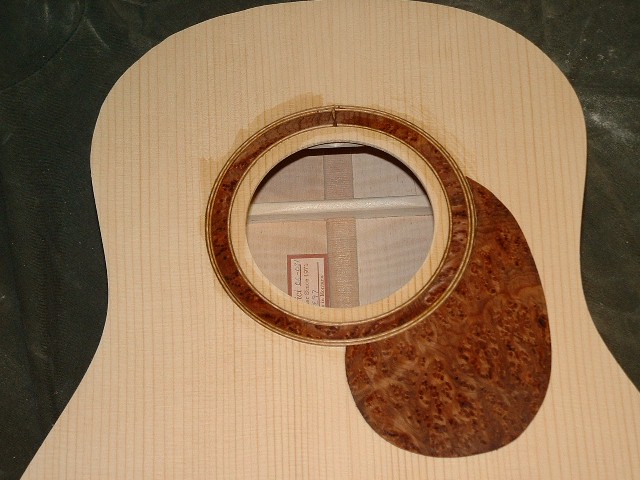

In the past I have always settled for plastic
pickguards. I would like to be able to match
my wood rosette rings. I have learned how to
make wood "potato chips" it just would be nice
if I could make something that stays flat.
If you have any ideas or tips please share.
Thanks!
Tom

You mean like
this
It is 0.03 inch thick macassar ebony veneer that was simply glued before
finishing and masked off before spraying with lacquer. I oil finished it so the
scratches can be fixed easier.KenMcKay38958.9324537037

thanks for the suggestion. pre-cut veneer would make
the job easier, I prefer to cut my own from burl
blocks Ive owned for some 20 yrs. I have already
made the rosette rings from slices off of the block.
I will try and heat my blanks with a iron that mite
solve my problem.

I bought 2 plastic sheets from S/M. Cut piece of plastic so it is a little larger than the pick guard.
Glue verneer to plastic, place plenty of weight on glued pickguard.
Next, cut protuding plastic even with verneer.
Bevel edges to about 45 degrees.
Now you have guard, mounted on plastic with either a thin black or white border to your pickguard, then can use double sided plastic film to mount.
Therefor, you can easily remove for repairs or to change the wood used for guard (make another laminate as above.
Just my idea.

I found my problem, the block I sliced for my first
try just don't like to stay flat. Grain problem.
Flat right off the saw, but as soon as I tried to
seal with shellac, they would curl.
Took a slice from a different block and it stays
flat, even after sealing with shellac.
It will work now, I love when I can blame the wood.
I rough cut the pickguard shape just to see how it
will look. What do you think?
Thanks Again!
Tom
http://www.moriciguitar.com
PostPosted: Wed Aug 30, 2006 12:16 pm
Now that's purty....
PostPosted: Wed Aug 30, 2006 2:50 pm
Purty indeed Tom!
PostPosted: Wed Aug 30, 2006 10:34 pm
Posts: 720
Hi Tom,
I REALLY like it ! Looks superb !
Regards Craig Lawrence
CRAIG LAWRENCE of AUSTRALIA
PostPosted: Thu Aug 31, 2006 12:00 am
Tom, I really like how it matches the rosette. That will make a great pickguard! Who need tortise when you have burlwood around?!
