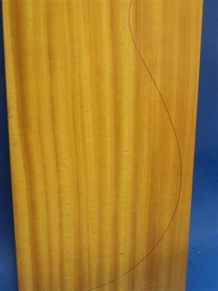

If you bought the wood at the 2005 ASIA Symposium, odds are the wood came from me.
Here's a sample pic of an African Satinwood board.
African Satinwood,Turraeanthus africanus, is strong and stable with a density similar to African mahogany. The wood bends easily too; I take my sides down to .085" and spritz each side piece with a good amount of distilled water prior to bending. You don't need to soak the wood. Use a moderate amount of heat and you'll find the sides bend very easily.

Steve, it probably was you, that photo you have looks exactly like mine. Wade, I'm not sure I understood your question but maybe the photo answers it.

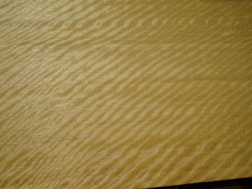

PostPosted: Wed Aug 30, 2006 1:22 pm
PostPosted: Wed Aug 30, 2006 1:29 pm
Well, okay, if it's got curl like that, maple would work!

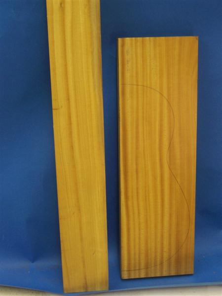

PostPosted: Thu Aug 31, 2006 11:24 am
Posts: 2221
This is Ceylon satinwood (chloroxylon swietenia).
It is very dense and beautiful!!
PostPosted: Thu Aug 31, 2006 1:20 pm
Nice, Brad! Now, that needs a sapele neck!
