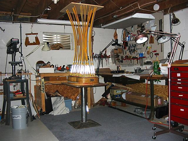

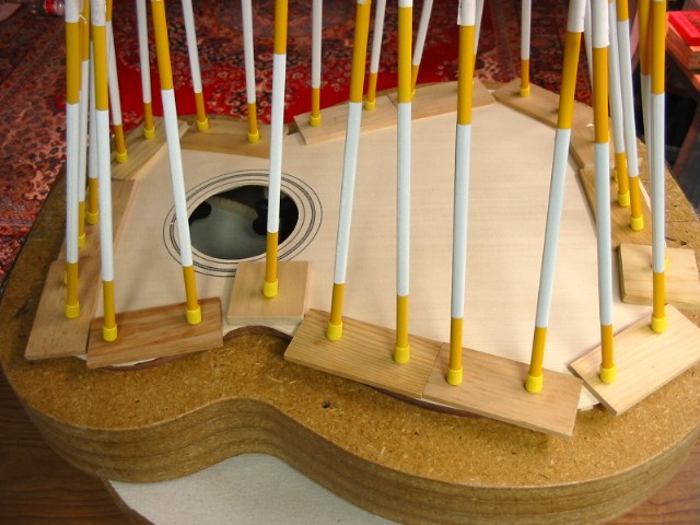

I used the spool clamps, the cam clamps, and on my last I switched to go bars. I really like the go bars.(CHEAPER than cam clamps)
Just make sure you keep things aligned before glueing
BTW, I didn't build a deck per se, Just set up a cafe table that's easy to walk around, and put a 2' X 2' chunk of MDF on the ceiling joists to recieve the ends of my 4'go bars from HD. I think I have 32 of them, stored up in the joists, outa the way when not in use. Later the cafe table goes back to holding up my cheesy table saw.

Terry, Thanks for the photo as well, it helps me to see how others are doing it.

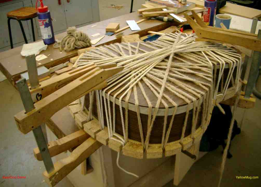

Gluing on a back rope up style.kiwigeo38963.4012037037
