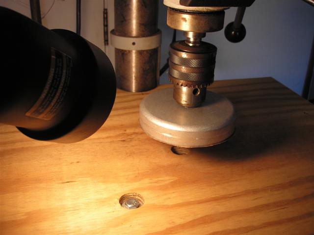

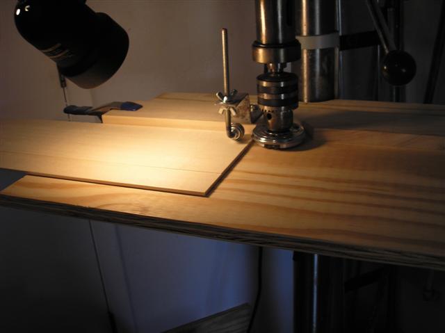

Mike I use a Wagner in the drill press for all of my back and side thinning, I find it very efficient if kept sharp, as of course all your tools should be! It's also great for fingerboards necks etc, wouldn't be without it.    Make a good table, fence and hold down and it will work fine. Finish off with a drill press sander or ROS.
I've opposite to most of the guys here, I've had a couple of thickness sanders and have got rid of them both and gone back to the Wagner as I prefer it. I think I'd probably have kept my 10-20 if I hadn't upgraded to the 16-32, but only use it for final finishing.

Dave, nice to see pics from your shop bud!
