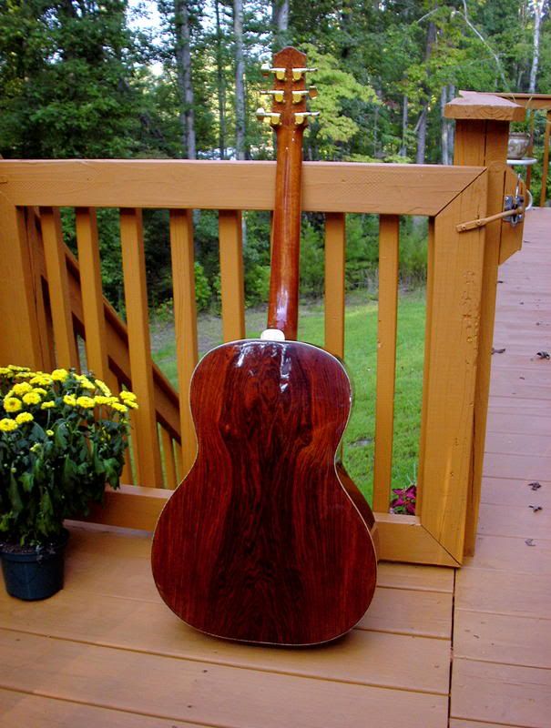

Well here is #2 all buffed and finished.....wow did I learn a lot from this one.
Greg
Gwaltney Guitars
PostPosted: Sun Sep 17, 2006 1:11 am
My goodness that is AWESOME...where do you live, I want to play it!!!   Gorgeous work. This has a wow factor of 10.
Details please, and maybe a full shot, or two, of the top. Thanks.

Wow, thanks everyone, I'll try to get a nice full frontal pic later on my deck!!

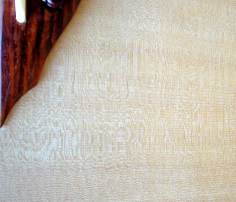

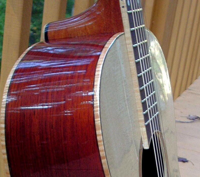

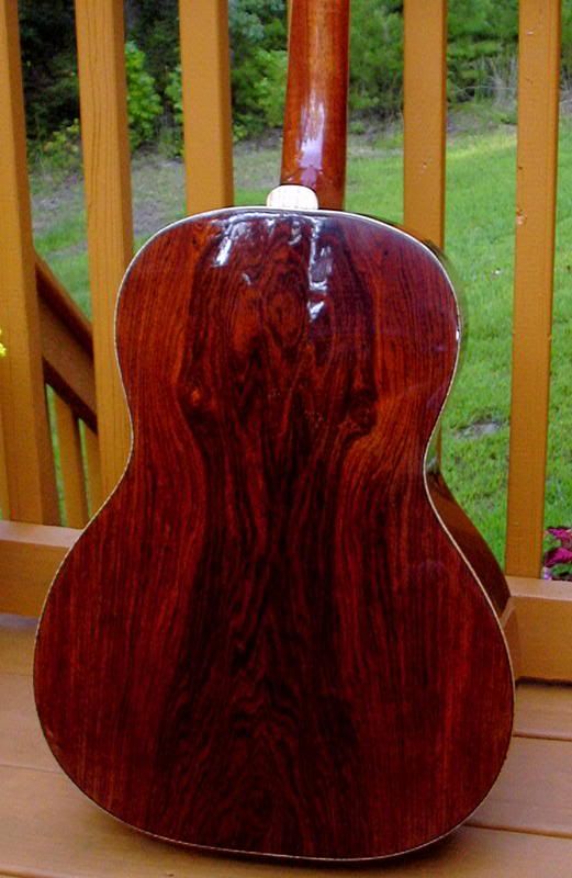

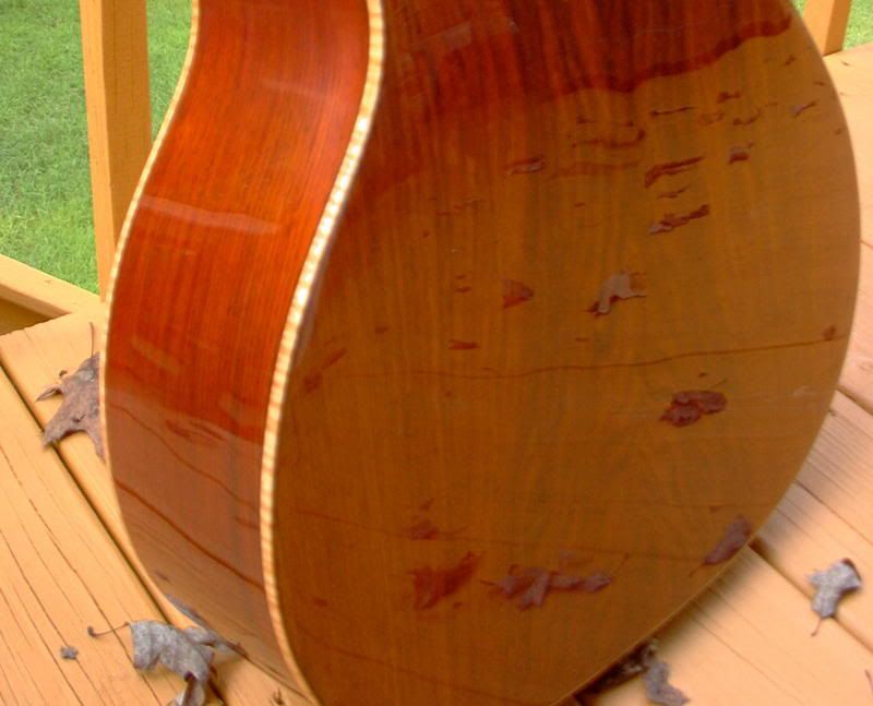

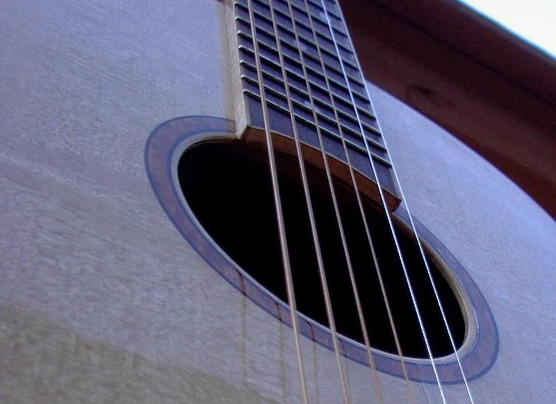

O.K. details, details....This is a 25.4" scale length 000-13 fretter with Cocobolo B/S & a Lutz Spruce top(with cool figure). The body is approx. 3 3/4"(neck) & 4 5/8"(Tail) deep, a bit more than a typical 000(I think). The top is/was very light weight, stiff, and has/had a great tap-tone. I used Lacewood for the headstock veneer & the rosette. The top was double "X" braced but I kept it thick, at around .125, with a gentle thinning toward the edges. Cocobolo bridge and fretboard. I used KTM-9 for the finish, I still think it is too soft but it sure does buff out nicely. How does she sound....Careful not to sound too flowery and enthusiastic, all I can say is, to my ear it is fantastic.....seems to have no breaking point/ceiling, it just keeps getting louder the harder you hit it...and is very sweet and responsive with a light touch, it really turned out great.

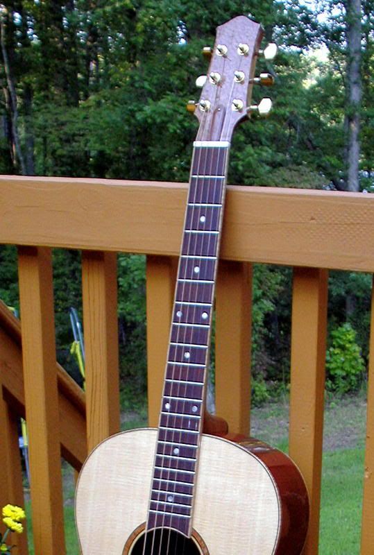

i'm also wondering if i'm see a finger board that is dead flat - or is that just the angle that the pictures were taken from doing that?
if it is a flat fingerboard, tell us how that affects playability.
phil
ps. the close up of the silk in the top is truly the kind of shot you need to be a builder to appreciate. i love it that you posted that.

I'm curious, too, about your flat fingerboard. A personal preference?

You know the flat fingerboard was an interesting experiment, I think it was a Froggy Bottom guitar(I think?) I played a while back that had a flat board and I really liked it, so I decided to try it on this one, and yes, I really like it. Funny that most players seem to like it as well, even if they have played forever on a radiused board. Even so I'm going to radius my next one at 16" and see how that works out.
