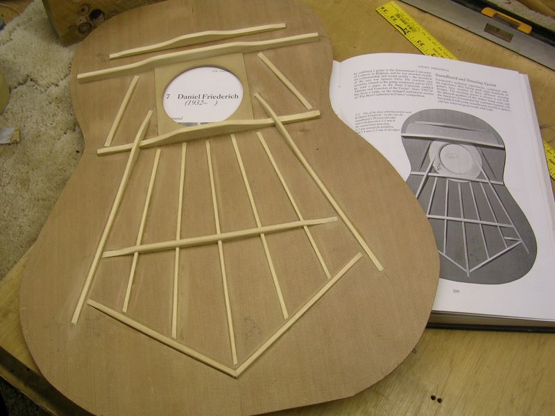

Yeah I know, I know. I still need to spend some time cleaning this up and I need to make some minor adjustments to the upper cross brace but I thought I'd give a peek at what I'm working on right now
Just don't mind the mess...
You can see here that I can't do anything "by the book".
Thanks for looking.

Nice looking Ronn...
Is that a fan braced SS? Looks a little big for a classical but it just might be the picture. Good work either way

Just the pics... It's a classical. The center fans are 3.5mm x 3.5mm and the center brace across the fans is 7mm x 7mm. Maybe that will help put into perspective.

OOOOOEEEEEE!! Nice piece of work, Ronn,
What mess?
Is the lower cross brace, above the V, notched to fit the fan braces?
I'm amazed at how much more intricate the tops of classicals are compared to SSs.
Keep us posted please!

Excellent work, I like that bracing pattern. What is the rest of the guitar plan?
PostPosted: Fri Sep 22, 2006 4:20 pm
Very nice work Ronn, yes, the bracing pattern of a classical seems to be a bit more work than what i'm used to on SS, looking at this pattern, a question came to mind, how would a classical perform with steel strings on? Or better yet, how would a Steel string guitar perform soundwise with such a bracing pattern?
I am asking because of the way the braces are placed, looking like it will make the sound travel in every directions easily, am i right?

Pat That brace is notched to receive the fan braces just as the outer fans are notched to receive the lower transverse brace (below the sound hole).
Mike the rest of the guitar? Its a indian rosewood cedar topped classical w/ rosewood binding and maple purfling.
Serge Boy you ask some tough questions. I can't answer. Sorry maybe someone else will be able to. There is a theory that says the braces direct the sound/vibrations out across the soundboard so..?
All of this is really experimental for me right now. I've been going through this book ("Building Master Guitars")and building several of the different styles there. All this just to experience the difference in sounds. I plan to settle down with one or two bracing patterns and try to refine the sound to my taste.

PostPosted: Fri Sep 22, 2006 5:57 pm
Posts: 1051
My opinion Serge is that for other than a very lightly strung small OO or smaller steel string that the Frederich bracing would not be strong enough for the string tension. Even with the cross bar in the bridge area it is still to light for a steel sring.
Theoretically you could take the brace dimensions and make them larger to get it to work for a steel string.
I would also be concerned about the amount of unbraced area around the perimeter as Frederich keeps his fan braces short and to the center of the top.

Ronn, nice looking work, mate! Studying the Freiderich picture your top is lying on, I noticed a wee little brace--sitting horizontally--at the top of the lower V.
All I can see is the bass side, so there could be one on the treble side. What do you suppose he's doing with that? To me (and here's a SS sting maker talking), it seems counter-intuitive. I don't get it. Is that explained?

[QUOTE=Steve Kinnaird] Ronn, nice looking work, mate! Studying the Freiderich picture your top is lying on, I noticed a wee little brace--sitting horizontally--at the top of the lower V.
Steve[/QUOTE]
Unfortunately it's not explained. There is one on both sides. I left them out. Look and you can see that I have deviated from the picture in other areas as well. Not for any good reason It's just what I did. Again this is all experimental. If I decide to build with this pattern again I may get a little closer to the picture/plan in the book.
I've been listening to Roberto Aussel and Alvaro Pierri lately. They both play Friederich guitars and the sound is, to my ears, quite different from what I am hearing from other makers. Not exactlly the sound I'm looking for(close), but very pleasant. The trebles are very piano like. I'm quite curious to see what this one sounds like.
