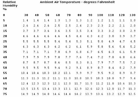

I have been offered the use of a bit of space in a large workshop. Its an old factory building shared between a cabinet maker and a sculptor. I think its a great opertunity but I wont be able to controll the humidity in the shop.
I've been looking through the archives here and at the MIMF and as far as I can see there are 3 options:
1. construct a kind of small room (more like a tent realy - plastic sheeting over a frame) just big enough to store the wood in and glue the braces to the top etc. and put a portable dehumidifier in there.
2. I've seen people talking of storing the wood in a cupboard with a lightbulb that heats it up. (This suprises me since although the RH drops as the air heats up surely the amount of water in the air and wood is the same). They then build everything in an uncontrolled workshop at 70% RH say and return it to the box after working on it.
3.Take a risk , build and see what happens!
Ambient conditions are currently around 65% RH (+/-10) at around 25 ?C. Both will drop as the autumn progresses.
Which method would you recomend in my situation ?
Thanks in advance for your advice

I would build the tent, or wait for the humidity to drop before bracing the top or back. You can go ahead and carve your neck, thickness and join the top and back, install rosette, bend the sides, and install end blocks and kerfing.

There are a lot of people who use option number 2, that would be my suggestion for you, it takes time for wood to adjust to RH so you should have no problem taking it out and working with it. The ideal goal for RH is 47 (at least that's what I think), what you can do is build a large cabinet and then look at cigar humidistat setups, THOSE people are NUTS about RH.

most sense to me. I prefer 42% at 72deg. This is the
average comfort level of living quarters. Wooden items
keep in the home, average about 8% moisture content.
That said I try to keep my wood and builds at 8%mc.

So you're saying that the temperarture doesn't matter as long as I get a RH which gives around 8 mc. Right ?
So today I'm at 80F 60% RH = 11.7% mc
So the idea is that I have to heat the cupboard till the temp and RH coincides with 8%mc.
My gut feeling would be that the MC would stay the same - I guess I must be wrong ?
Richard

Temperature has less to do with mc than the humidity,
the chart shows that. Relative humidity is what you
need to watch. The storage cabinet needs to vent too
help drive off moisture. You need to raise the temp.
for that to happen. There is room to play with on the
moisture content of wood, it depends on where the instrument will live.
On the coast RH is higher 10% is better, in a dry desert region Id feel safer with 6%.
Hope this helps.

I've ordered my wood now. Once it arrives how long should I wait to let it stabilise before I start building ?

I agree with martin, it would depend on the condition
your wood is in when you recieve it.
If you store your wood in a controlled conditions
a few weeks "could" be enough. to be sure weigh your
wood when you get it, a postal type scale should work.
Weigh it once a week. When it stops losing weight.
It should be stabilised. hope this helps.
