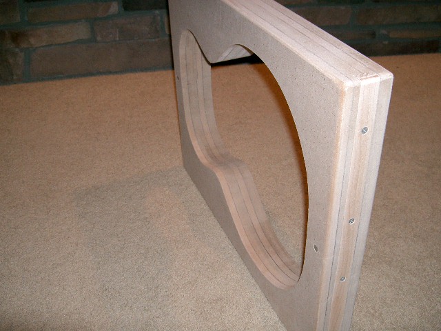

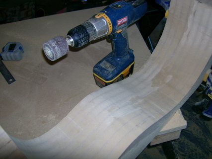

I've had a heck of a time creating my outside mold. Bandsaw troubles mainly. But anyway. I've done what I can with what I have. That leads me to the question "Is it enough?" Obviously, I'm no expert in luthiery. It looks like the mold is too rough. I've done my best to sand it, but I don't have a spindle sander as you see in the pics. How smooth and even does the mold need to be? Will the side contain dents and stuff if the mold does? It's really wavy to the touch. Yeah, I know it's a noob question :) pics follow

Nathan, i would suggest you buy a sleeve with sand paper that will fit a drill press, you really want it smooth and even in there.Serge Poirier38992.8889814815

Nathan, how close are you to the drawn line?

I am sure others can tell you how important it is for the mold to be smooth but it is essential that the sides of the mold are perpendicular to the face of the mold (square). One way that I accomplished this was to make a template first. I used a piece of 1/2 MDF. I cut out the template with a jig saw. Once the template was cut out I filed the edge to get it smooth. This is much easier to do on the template because it is only 1/2" thick. Once I had a template I used a few peices of double sided carpet tape to tape the template to the precut molds (like you have in your picture). With the template mounted to the rough cut molds you can use a template type router bit to transfer the pattern from the template to the mold. This process will ensure the molds sides are perpendicular and smooth without sanding. If you make a template a little oversized you should be able to clean up your current mold fairly easily.
Good luck!
Brad
Avon, OH
PostPosted: Mon Oct 02, 2006 12:41 pm
Posts: 1051
What I do is saw the first layer close to finished shape and then sand till it is exactly to profile. I then the layers together and drill alignment holes through the layers and draw the outline that needs to be cut on the other layers.
I then disassemble the stack bandsaw each of the other layers to close to the line scribed from the first one that is correct. I then pin the reference profile piece to the second and use a router with a flash trim bit to cut the second layer to exactly the first and repeat that operation for as many layers as needed.
At that point, because all the layers have alignment holes and have been flush trimmed to the first, the stack will be very even and close to final shape without having to deal with much sanding. The stack can be glued and assembled and it only takes a little bit of hand sanding with a block to finish it.
While this is more steps than what you did, the end result is less dependent on even sanding and works very nicely.

Shawn's process is similar to mine except he uses his first layer as the template. Pretty good idea.

Serge - I don't own a drill press.
        I'm pretty much right on the line (after sanding)
Hesh - Thanks. I'm doing what I can with what I got
Brad - Hmm, I do have router. So let me get this right. There's two "halves" then each half has a side. So I would use the template and router on half 1 side 1 and then half 1 side 2. Then repeat the process?

[Quote=nathan c]So I would use the template and router on half 1 side 1 and then half 1 side 2. Then repeat the process?[/QUOTE]
I guess I should have explained things a little better.
The process works well if you have a 1 template router bit with the bearing on top and 1 template router bit with the bearing on the bottom. This is the process I use:
1) Mount template to top of mold
2) Use top bearing router bit to route along template from top side. This will probably allow you to plunge about 3/4 - 1" deep.
3) I them flip the mold over and use the bottom bearing router bit to route from the other side. I use a 2" long bit that bearing will reach the area that was routed in step 2.

PostPosted: Mon Oct 02, 2006 2:11 pm
Nathan, one other thing if I may...
How thick are you making the mold? In the picture, it sure looks thick, unless of course that is both halfs of the mold clamped together. Than it looks like it should be fine.
I sure like the router method when making molds, it's much much more accurate than the way your doing it. On the first mold I attempted to make was so out of square. It sure made good fire wood though .
Take the advise already writen here and maybe start over (sorry to say it) and make one perfect piece, and use the dowel method mentioned by Shawn, you will have a nice mold when it's all done.
Or you could just purchase a nice mold and bending form from John Hall at Blues Creek guitars (he's a sponser with realy good stuff). But, sometimes finances can't support such a purchase and you have to resort to making your own.

Rod - Yes that's both halves clamped together. I've decided to trash this mold and start a new one. I could buy a mold, but I would rather use the cash to buy tonewood and besides, creating the jigs is half the fun!
