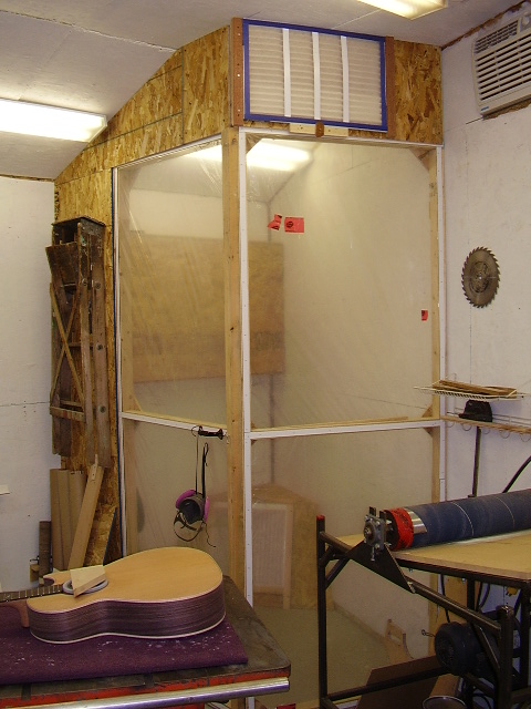

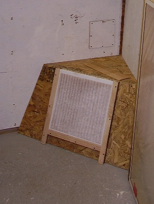

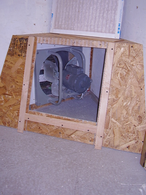

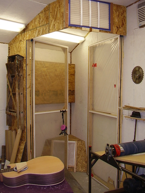

I have a small spray booth set up in a corner of my small shop. I have doors that are hinged to help open up the space when the booth is not in use. I have an explosion proof fan at the floor level and a "clean" air inlet near the roof. Both the fan and the clean air inlet have good quality furnace filters. I now have an air cleaner which I will run for some time before spraying. Since my booth is inside the shop, temperature and humidity are all the same.
I also have a small cabinet which can hold 2 bodies and 2 necks while curring.
Here are some pics.

Mike, yes it exhaust to the direct outdoors. It wasn't a big deal installing. I built the shop so I knew what I was getting myself into. The filter picks up 95% of the particulate (estimated at least as there is very little on the fan, and none on the ground outside). So mostly it's just the fumes that are really being vented, I think and I've had none of my neighbors say anything about it. They all know what I'm doing in the shop with no complaints so far.

Man Rod! That is so cool! The vent box is ich! The only thing that I would do different is doors opening out. Is there something I'm not seeing there!
I like the curing cabinet, keeps everything safe!

Billy, my only problem with swinging the doors out is that the rest of the shop gets in the way. These pictures are taken from the main entrance door. Not much room in there at all.    But it's mine....All mine
