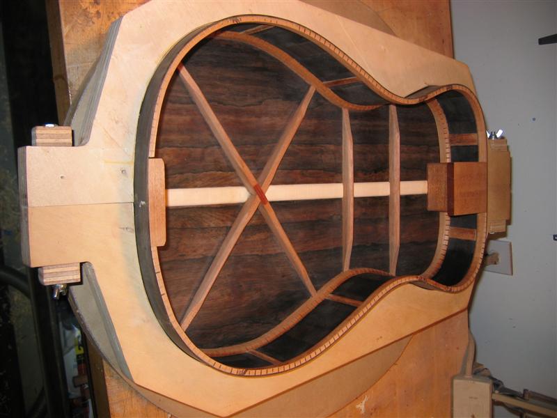

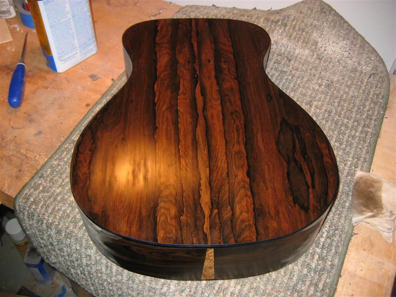

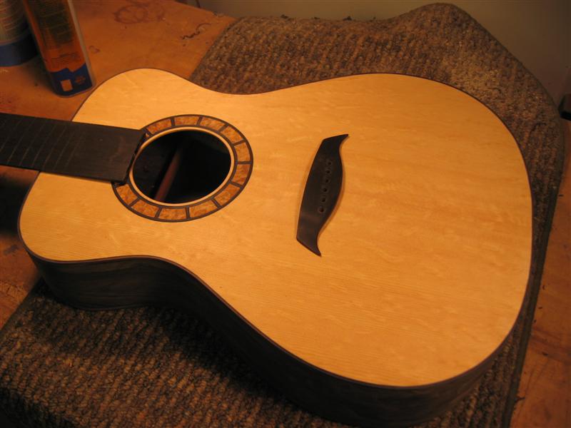

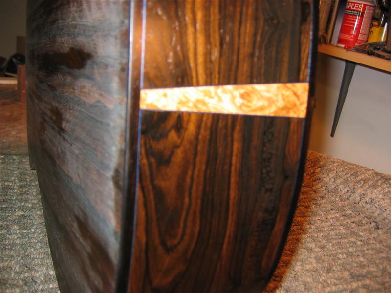

Number 5 seems to be taking forever, but so far it's shaping up nicely. The box is done and I've just started working on the neck. Ziricote and the streaked ebony bindings are from the Zootman. It's hard to see in the pics, but there's a single 020 blue purfling line on the top, back and sides. It really pops when you get a close look. I'm going to try a double m&t neck joint and the X braced back is also a first for me.
Thanks for looking.

Hey in this picture
It looks like you only have 16 fret slots cut, is the board not finished or are you just installing 16 frets?

Rod, it's a regualar 20 fret neck, I just haven't cut the excess off yet. Actually I'm really just hiding an ugly gap in the rosette.

Walter, This is the first time I've worked with ziricote and it's been both easier and more difficult than I expected. It was difficult for me to dimension. I have an old ryobi drum sander and even with fresh paper, the slowest feed rate and barely taking 1/64th passes th paper still gummed up after half a pass. I then tried the safefty planer but it left a less than even finish (the sides had a small cup) that was difficult to clean. Lastly I got a router thickness jig that did the trick. I've commented on this before and have heard that ziricote shouldn't be that difficult to dimension, maybe this set was an exception. On the easier than expected side, bending with a form and blanket went smoothly. I followed someone's advice (I recently lost all my bookmarks when my harddrive crashed so I can't remember who it was) and coated the set with CA. The advice said before bending and of course I had already bent the first side so I coated afterwards. With a reputation for splitting I also went crazy with the bias tape and side braces. Beyond I haven't found anything unusual. BTW, good idea I should have put up some commentary rather than basically just pics.
