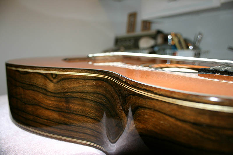

I lurk more than I post but here are a few shots of my first classical build:
The Ziricote back:

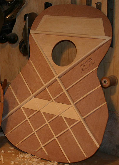

The bracing pattern for those who are interested:

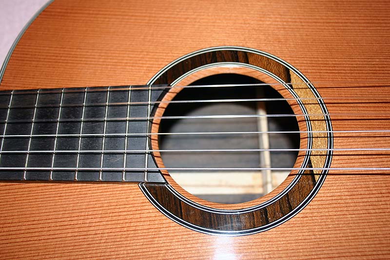

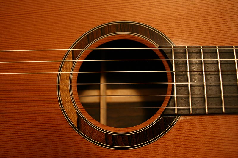

Man that's a nice guitar! Can we get a closeup of the rosette?

Thanks guys, I'll take some shots of the rosette tonight. Basically, it's another piece of Ziricote bound in black and white.

Very nice. I can't wait to see the rosette up close.
How did you decide on the bracing pattern?

I followed the pattern that Sergei de Jonge has been using for some time. It seemed to avoid the pitfalls of the distorted lower bout that I've seen in quite a few older fan-braced classicals.

Posts: 2356
Warren,
Very nice effort! Congrats! Can you attempt to describe the sound to us and how you think that bracing pattern may have played a role in the overall sound?

Firstly, it's way too early to tell. Three players commented on this right away. That it sounded very new. "Play it and come back in a month.", they said. I'll place it in front of the speaker and blast Rachel Gauk and Sylvie Proulx at it for a few weeks. I'll expect the guitar to play as well as them afterwards.
Sergei and Joshia use the same pattern so maybe this review is appropriate:     http://www.guitarsint.com/detail.cfm/id/431
I'm not good at judging the sound of nylon-stringed instruments. To me, mine sounded like everything else being built in the shop at the time including the aforementioned classical from Joshia. I would call it balanced but I think there's a lot more bass to come...

Here's the rosette, as promised and an overlit look at the waist (don't worry - the knots are zapped up).
