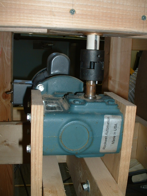

You can also use a right-angle gear reducer. These require C-face motors, but otherwise simplify the drive assemble quite a bit. Mine is a Dodge Tigear 15:1 reducer. With a 3/4 HP 1725 motor I get 115 RPM. Got the unit on eBay for $40. Of course, the shipping also cost $40 (heavy thing!).
Here's a pic:
Good Luck!
Jim
