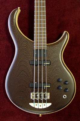

I've never worked with wenge but heard it has a rosewood sound. I remember a guy at the 2003 Healdsburg guitar fest that had a classical made of spruce and wenge. The wenge was quartered and from a distance it looked like ebony until you got 10 feet away and could see the alternating black and dark brown grain lines. I found the below picture of an electric bass on the internet - I don't know who built this, it was on a webpage showing different shots of unfinished wenge. This wenge is flatsawn and the grain is more prominent than quartersawn stock.

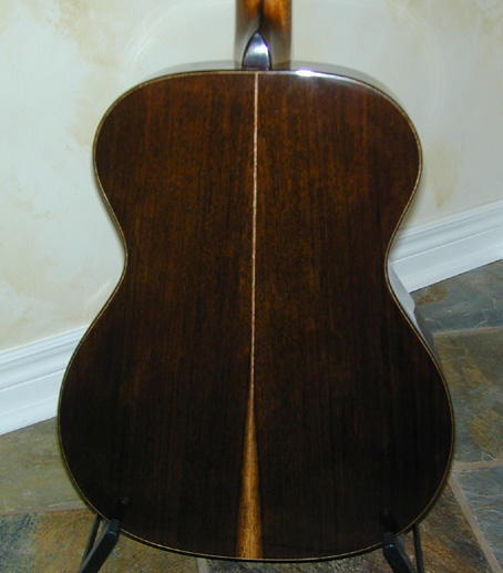

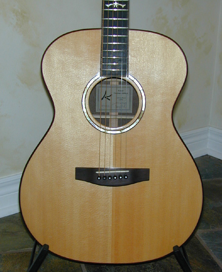

PostPosted: Tue Oct 31, 2006 12:05 am
Here is the OM .. looking thru the pix I also found/remembered that I made a long scale parlour venetian from the same board. This one is bound on wenge as well, and the purf is blk/red/blk, the rosette is gold MOP. Bridge is afr blackwood, the neck has been stained darker to match the back a bit better. I usually dont do that, but this one I tried it out. Just going to show you never know what you might find, that is an A grade top, but shows lots of pretty shimmer ... cheap too !!!
