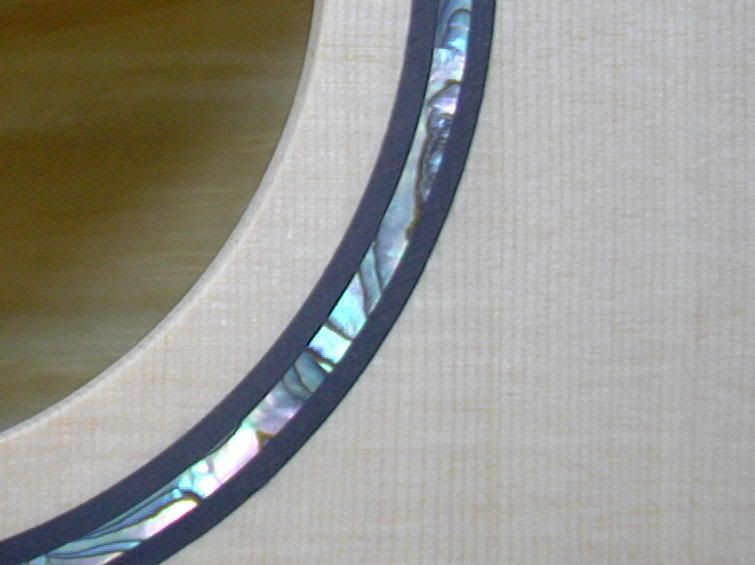

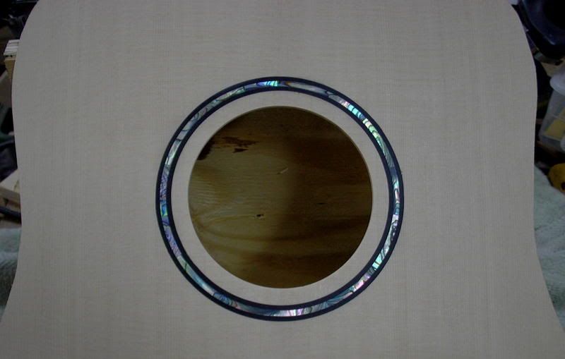

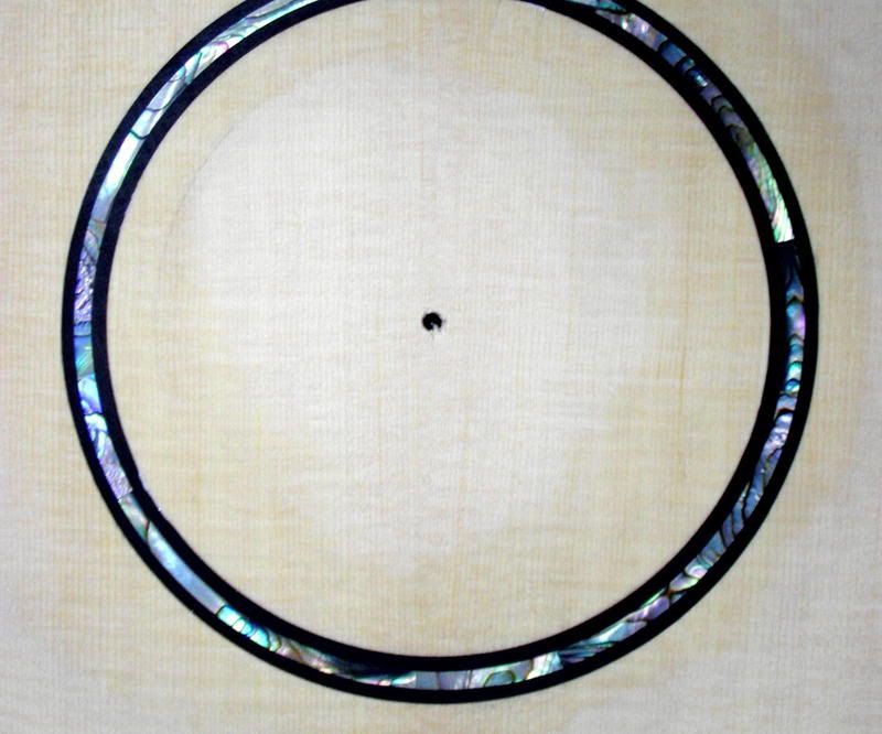

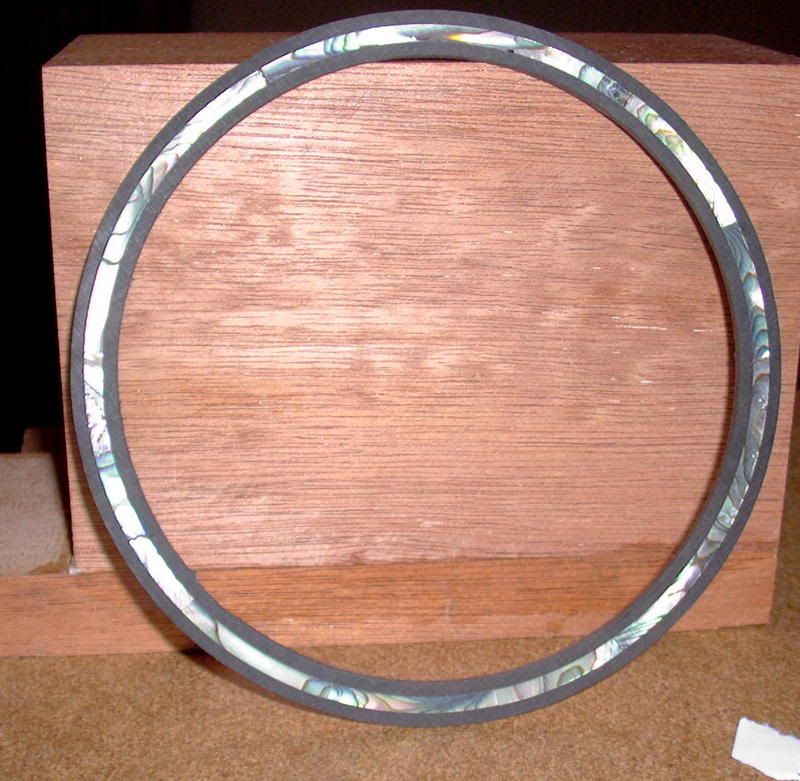

I'm well into guitar #3, just thought I would share a few pics of the rosette, my first attempt with abalone.....what do you think?

I Love it!! Simple and elegent but with bold lines. Very nice.
PostPosted: Sat Oct 28, 2006 2:28 pm
Wow, that close-up shot shows no flaws!
Very nice, tight work.
PostPosted: Sat Oct 28, 2006 3:02 pm
Looks Awesome Greg, Great Job!
PostPosted: Sat Oct 28, 2006 3:14 pm
I like that very much. VERY clean work.
PostPosted: Sat Oct 28, 2006 3:40 pm
Beautiful!

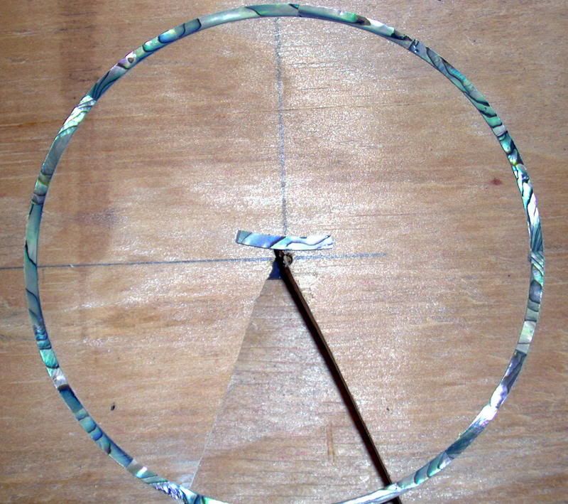

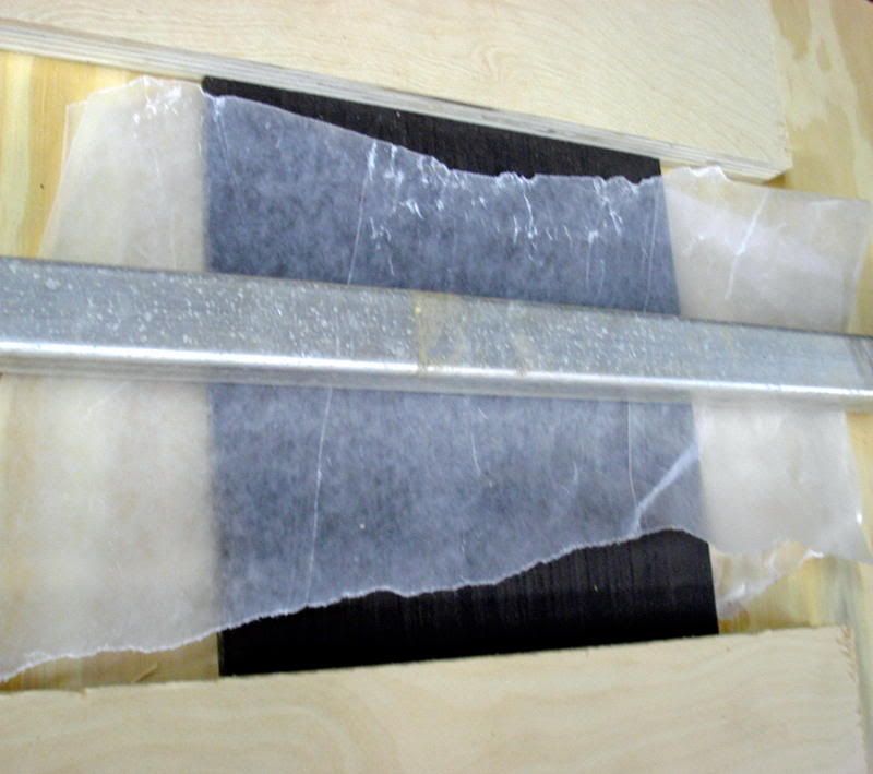

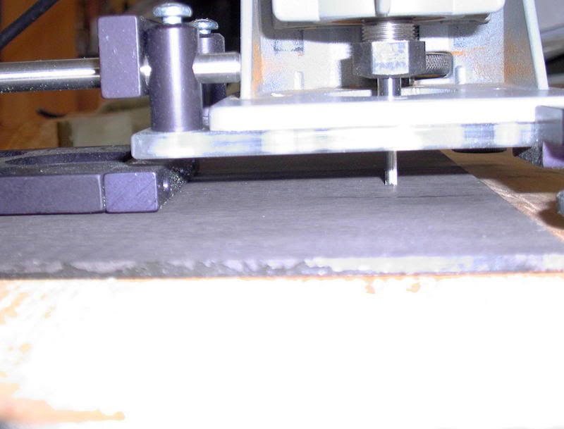

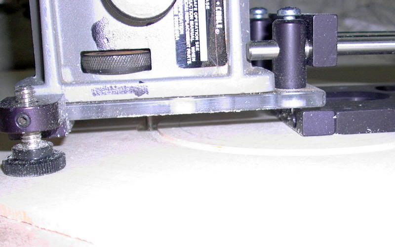

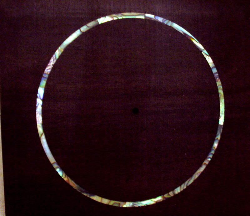

Hi Steve, here is the process I used.
First I took some ebony, resawed it, jointed it, edge glued and sanded to appropriate thickness.
http://i15.photobucket.com/albums/a361/GregGwaltney/ebonybef orerosettechannelcut.jpg">
Here I am cutting the channel in the ebony for the abalone with the Micro-Fence jig. Also shown is the little jig used for mitering the abalone(thanks Peter) and the abalone dry-fit in the ebony, then CA flooded.
Then using the Micro-Fence and an 1/8" bit I cut the ebony and abalone rosette out of the ebony square, then measure carefully, test cut on a piece of plywood, transfer measurements to channel in the spruce top. Make sure everything looks good because the fit is VERY tight, once the rosette is in it's not coming out without damage to the top. So I apply glue and press the rosette into the spruce top channel. I make the channel in the spruce top within a few thousands of an inch of the actual rosette diameter, so it is very snug indeed, the Micro-fence is helpful in this regard as it allows slight adjustments. Another thing I do with the Micro-Fence that helps me is that I use two center pins, one in the test piece of plywood and one in the spruce top. I find the exact inside diameter on the test piece using calipers, move the already set micro-fence over to the spruce top on it's center pin, cut, then go back and do the same routine for the outside diameter. Took me most of a day to complete, next time will be quicker though as I had to build the little plywood jig for the abalone this time.
Hope that was helpful,
Greg

Looks like this photo didn't show up, here is the resulting rosette freshly pressed into the top, still wet from glue clean-up. And I'll add another of the rosette flush sanded.
Greg
Gwaltney Guitars

Greg -- great looking rosette and thanks for the tutorial.
Was the paua pre-radiused exactly or did you bend it in?

It was pre-radiused....thank goodness for that!!
