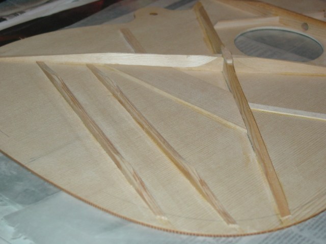

Here are pics of my very first in progress. I am a bit scared to show these as they are still quite rough looking, even to my novice eyes, and not yet cleaned up. But my wife insists that I share my progress. This is an OM and most of the parts are from John Hall.
I am really struggling about what to do with the top braces. I have carved a bit and tapped a bit and the top is loosening up a bit. Arrrrgh. I hate it when I haven't the slightest idea of what I am doing. All suggestions/critique welcome.

Looking good, Steve. I agree with the above. I didn't really try to tune my first, or 2nd or 3rd top. I did a lot of tapping thoug, so I could learn how my bracing sounded and I could use that experience to experiment more in the future. It will sound great without tuning. I just recommend shaping the braces to a proven shape and size for your first.

The back & sides look very clean and well executed. Hesh is right about installing side supports to stop cracks should they develop. I like your neck block...that extension should help to keep the FB flat and well supported.
The top is obviously in the midst of fine tuning. Hesh's bracing is a good example of one approach to opening up the top and is a good guideline. Do you have any pics of the bracing as seen from a low angle? Oh, and clean up that sawdust so we can see things a little clearer
As far as tap tuning the top, I always characterize materials as having "rings or thuds". The trick is to turn the "thuddiness into ringiness." John Mayes' DVD helped me tremendously. If you have access to a luthier in your area, you might take your top and a sharp chisel (along with a six-pack) and talk tap tuning for an hour.
Your first one will be a good measuring stick for subsequent guitars. For now, just keep carving braces until you hear rings and sustain.

Hesh - did you only run your transverse brace ends and the lower bout legs of your x-braces through the kerfing to aid the top movement? Is that fairly common?

Do you have a copy of the Martin herringbone plan? (And guys, is there one for an OM?) The brace profiles are there, and will be a good guide as you learn to "take away wood". If you end up with a Martin sound, well that's not so terribly bad. But you will have learned something valuable in the process.
Do you have a piano nearby? Perhaps a tuner?
Find the pitch that your top is giving you now. Check it often as work progresses, and as wood comes off.
I'm not suggesting you go for a certain pitch--I don't think that's necessary--just listen to the changes that are being made as you work. That too will be valuable.
And run your hand over the top. Almost like you are wiping something off of it. Listen and feel what the top is doing. Carve a bit. Run your hand some more.
All these things will start to help you develop a sense of the changes in the top as you work.

Hesh, it looks like the X-brace is about 1" in the centre with a pretty steep taper...am I seeing it correctly?

Doug, the sides have a bit of spring in 'em, so I will leave the rim in the mold to maintain their shape until the top and back are glued on. Then I will open up the mortise and make the cut for the end graft. It might be easier to do it another way, but I am most interested in having a guitar with a proper guitar shape.
