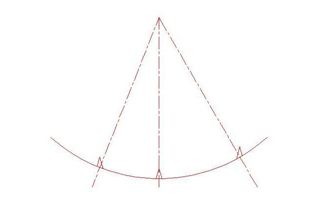

Here's a real rough and dirty explanation.
This is an over exagerated cross section of the dome with braces in "some" location along that cross section.
Seeing as we want all the braces to be "vertical" and not perpendicular to the curve of the dome, each brace has a slight bevel on one side or the other, as none of them are truly on the center or lowest point of the dome.
Being that this is on a 15' diameter dome, I don't think it really matters all that much but this is the explanation that I've always thought was the issue with the dome versus just using arches to clamp down the braces with.
PostPosted: Thu Nov 02, 2006 12:15 pm
[QUOTE=JJ Donohue] Carlton, I'd be interested in understanding the background source for the knowledgeable advice to which you referred.[/QUOTE]
Abe Wechter. Good enough for me, 'cause he understands more than I ever will. BTW, Rod's diagram nails it on the head, or the apex, if you will.

    Actually, one could sand in the center as long as the angle to the centerline is maintained per it's place in the radius on the back of the guitar. It's the braces angle to the centerline that's important
   To get an idea of the error possible exagerate the position even further to the side of the spherical radius. The shape would get very odd, more like a cannon balls path shot into the air than a radius.
I hope this explains it better so you can sleep!
