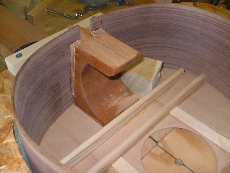

Here are the slots Joshua was talking about. In the second pic you can see the wedges are glued in...

Thanks for the info guys.
And thanks Ron for the pics.
Great looking guitar, Ron.
It looks as though you've put finish on the foot internals.
The one i'm making is a flamenco so i scrimped as much as i could to save weight and made the foot internals alot smaller.
I think if i took more timber out to make wedge slots i'd be comprimisng strength in my build.

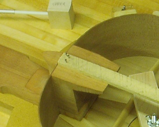

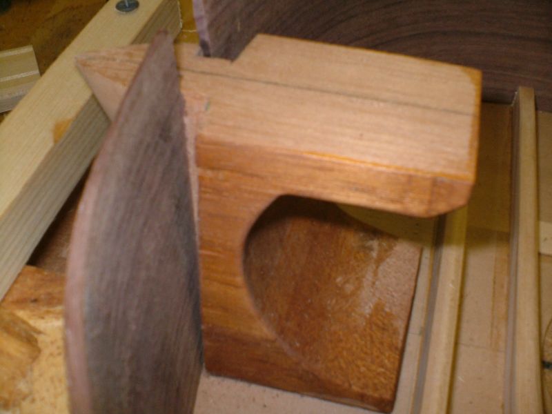

I'm not real sure what you'd like to see. Here is a few more pics. Maybe JFrench will find his. I'd enjoy seeing them as well.
This last one is really deceptive. The slots look a LOT larger than what they really are. After cutting away the slots the Piece of wood that is left still connecting the heel/foot to the neck is about 10mm-15mm wide on the bottom and tapers up to about 35mm wide under the fingerboard. I'm not looking at one but I believe thats pretty close.
PostPosted: Fri Nov 17, 2006 6:31 pm
    Ah! Neck and block same! Little slots and wedges hold sides! I've never seen that! Doesn't look especially solid!
    Classical only right? I'd hate to do a reset on that! Thanks Ron.

[QUOTE=Billy T]     Ah! Neck and block same! Little slots and wedges hold sides! I've never seen that! Doesn't look especially solid!
    Classical only right? I'd hate to do a reset on that! Thanks Ron.[/QUOTE]
This type of joint is extremely solid and stable over the long run when done properly. Yes, this is classical only, and there is usually no neck resets done on classical guitars. If something gets way out of whack, the easier solution is to remove the fretboard and plane it to the correct angle again.
