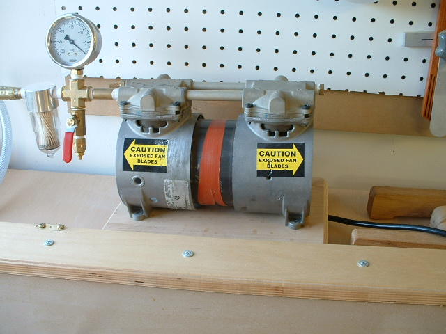

I've used the little venturi pump from LMI for the last 6 years or so ... works well. I've switched over to a continuos vacuum pump system which I like much more. I use the refurbished Thomas pump from joewoodworker.com. Great little unit:

PostPosted: Fri Nov 17, 2006 9:53 am
[QUOTE=Tom Harbin] Thanks Simon: Anyone else out there that has done a Joe Woodworker vacuum kit, please let me know which type and how you like it. tom[/QUOTE]
I have the Joe Woodworker set up with the GAST pump. It works flawlessly.

Posts: 1051
I have been using the vacuum pump system as per joewoodworker's plans for over 3 years with perfect results.
I bought a used Gast pump on eBay before he started selling them on his site.
It is much quieter than a venturi system, especially when you use a large auxillary tank to reduce the pump cycling.

Location: Siloam Springs, AR
Shawn, which style/model of Gast pump did you get, rotary vane or diaphragm? Something else? Thanks for the review, I'm seriously looking into making one. Noise is a big issue for me, which is why I suspect I'd like the JW system over the continuous run pump on the LMI setup.
