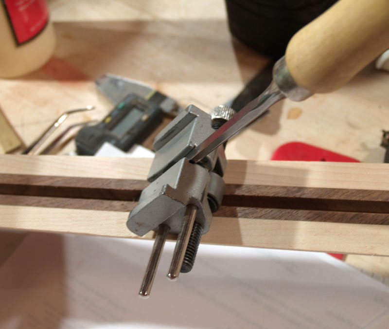

The router plane is definitely the way to go, but no need to buy one if you have a cheapo honing guide lying around...

[QUOTE=John Watkins] The router plane is definitely the way to go, but no need to buy one if you have a cheapo honing guide lying around...[/QUOTE]
Very clever John, I will remember that one, veeeerrrry clever
Brock, if you make a caul to hold the back of the neck I bet it will come in handy for lots of jobs after this one down the track. If you do not want to go to the trouble, maybe you could pack out your vice with some high density foam rubber and clamp the neck from the side.
Another alternative is to proceed ahead and get the tuner holes drilled. Make a flat block caul with some dowels protruding in the same pattern as those in the peghead, you should only need 2. Clamp the caul in a vice or onto a bench and then clamp the heel to support it laterally and you should be set to go with Johns trick,(veeeery clever John) or a 271 router plane, or a scraper as suggested above.
