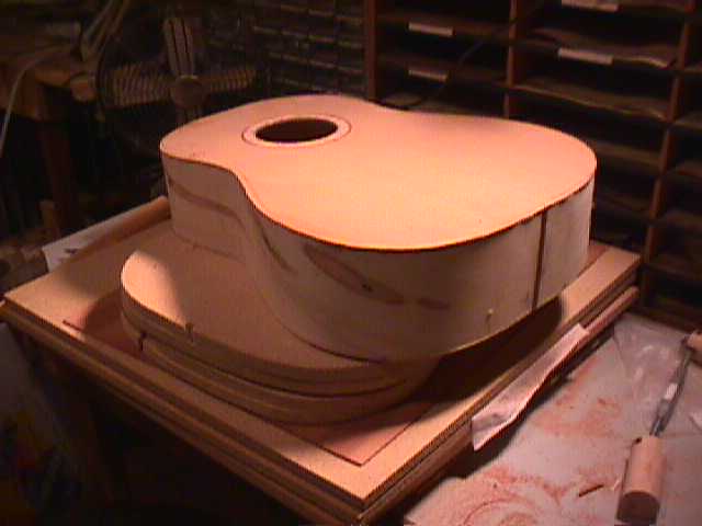

Well I got some time in the shop during the Holiday this week and thought I would share my progress.

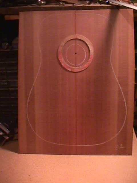

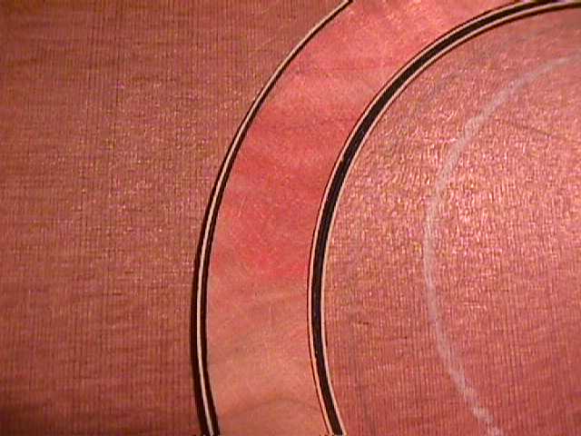

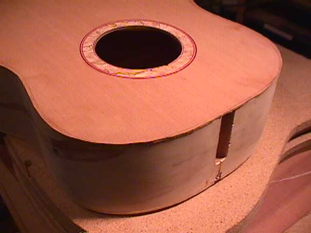

Steve, here is the rosette on the Sweet Ambrosia and a photo of the WRC Top.

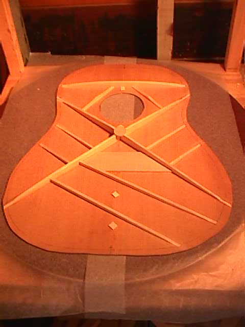

Serge, here is pic of my top bracing on the WRC - Ambrosia

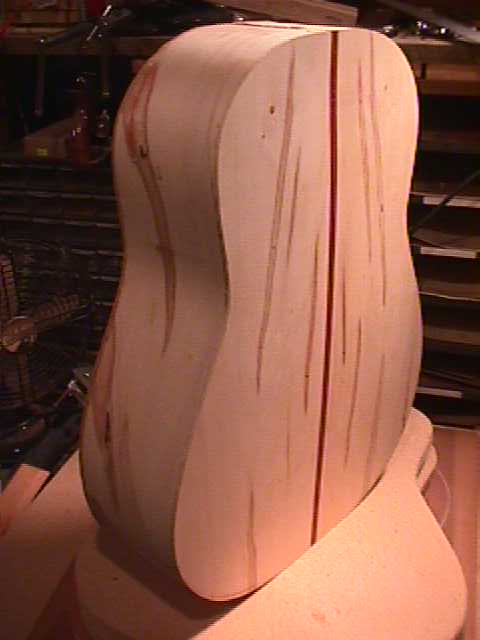

Got the box closed and trimmed out getting ready for cutting the binding & purfling ledges and install

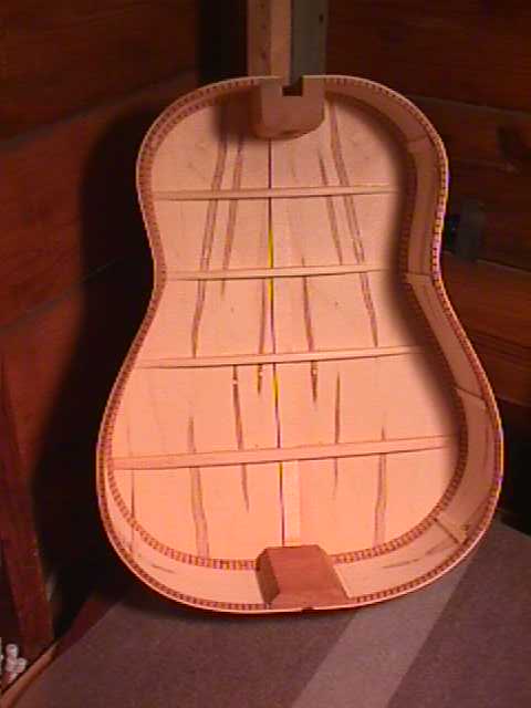

My 2nd in this batch is the Curly Cherry with WRC Top as well. Got it ready to glue the back, this is an inside shop before glueing

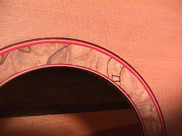

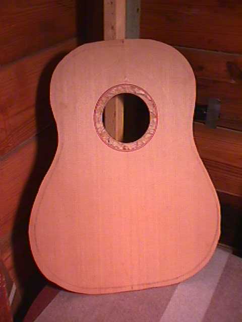

This is a pic of the wild WRC I got in from AC Tonewoods with the rosette just sitting in and not glued.
Here is a closeup of the rosette, it is some of the Zootmans new Box Alder

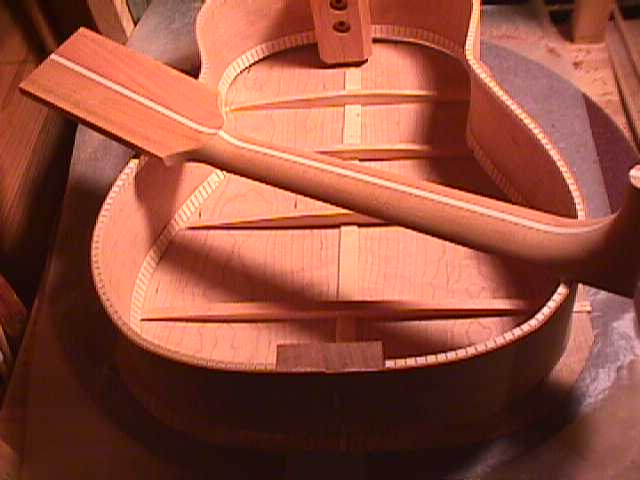

Here is the box with the neck on this one

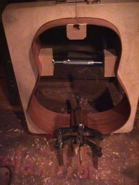

The final in the J-35 group is in line and is a Striped Sapele and here it is in the mold after setting the neck block and tail block.

Great stuff, Mike!
Love that rosette, and everything else to boot.
What sort of finish are you planning?
PostPosted: Fri Nov 24, 2006 3:16 pm
What Steve said! Box alder rosette -- it looks great with the ambrosia ribs/back.

Steve, on the Ambrosia, I have a friend who owns a cabinet shop here in town and he is going to assist in finishing with Nitro spray. I will do the sanding prior and during the process, they have a really nice big and safe spray booth. I want to keep all my wood colors as light and bright on this one as possible. On the Curly Cherry/WRC I am thinking of going with the RussellR approach with Danish Oil.On the Striped Sapele/Bearclaw Sitka I am going to use Behlen's Rock Hard Table Top Varnish.
Steve, did you pore fill at all,(there are none) or just seal coat with Shellac and move to finish?
Thanks Anthony, I have really enjoyed making rosettes here lately, getting ready to do a Turqois Ambrosia Maple guitar in the next batch. The color streaks are Turqois/green vs. the red/pink on this one. I will be making the rosette and accents using faux Turqois and using green and blue in the purfs. Have not planned everything yet, but it should be something different.
Thanks Hesh, you and Colin converted me and I really like the change. The bracing on these tops are as light as I have ever worked with, no meat at all, but the tap tone is awesome. Thanks to you and Colin for answering my questions and giving info and advice.

That looks awesome... Very nice clean work and your bracing is very simillar to mine! I love the parabolic bracing as well...
Mike, my finish schedule on this one was fairly simple.
Sand to 220, then ship to Tony.
He did the rest. He told me he normally uses epoxy as a filler/sealer, even on maple, but he was concerned enough on that Ambrosia about splotchiness that he didn't use it.
What he did--I think--is go straight to the urethane.
I don't know if he uses anything between the epoxy and the urethane or not. But if you are going to use nitro, I'd shoot a couple sealer coats of compatible vinyl sealer, then start the clear coats. I wouldn't worry about any fill work. The only "pores" are those left by the beetles. And you've got them under control I'm sure.

You're getting an impressive amount of work done there, and it all looks quite good! On your Ambrosia top, does the rosette actually go up to the edge of the soundhole, or is there a black binding too? Is there a story behind this?
