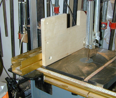

I just resawed 2 imbuya and 10 curly mahog sets the other day on the same 20 buck blade. I use a 1/2-3T on my 3/4 hp delta 14 with riser block, and get them from a local place called R&D bandsaws - he exhibits at most of the cdn wood shows, and I have nad nothing but these ever on my saw - they are cheap and work awesome. I also use a Mule badsaw fence, and have a modded add on on high fence made from baltic birch ply - the modded part comes frm the fact it is U shaped in the vertical plane, such that the whole blade guide assembly can drop down into it and I have about a 5 inch high fence, but on either side of the cutout its about 8 inches or so high for backs and top resawing. The fence is set square to the table and the blade, the saw has rpetty much no drift - the blade and wheels are set so that the blade leaves the upper wheelin the middle of the tire - thus it hits the table square to the fence.

here tis ... basicaly just cut out a section that allows the blade assembly to drop in ... easy enough - I got tired of having to cut sides with a 8 inch high fence, or backs with a 5 inch fence, so this solves the problem .. it has the ability to do both, or I just take it out to do 2 inch stuff with the Mule.
R&D uses either industrial or swedish steel on the blades - the swedish stock went up in price, so they are the same price now, so I buy the industrials, the industrial blades have hardened edges front and back - they run true, and if you buy more than 3 blades, they give 15 points off ...
