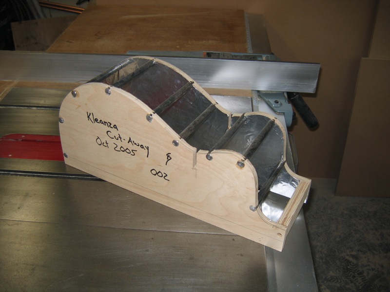

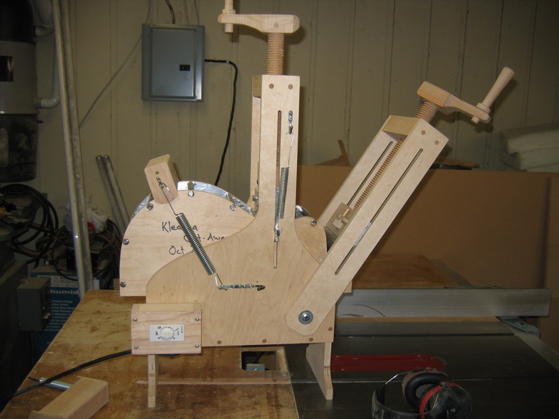

There has been a bit of talk about side benders lately so I thought I would post a couple of pics of the one I built from the LMI plans. The plans don't show how to build or where to join the cutaway attachment so I bought their video and just watched buddy burn himself a couple of times and estimated where to place the pivot for the this attachment.

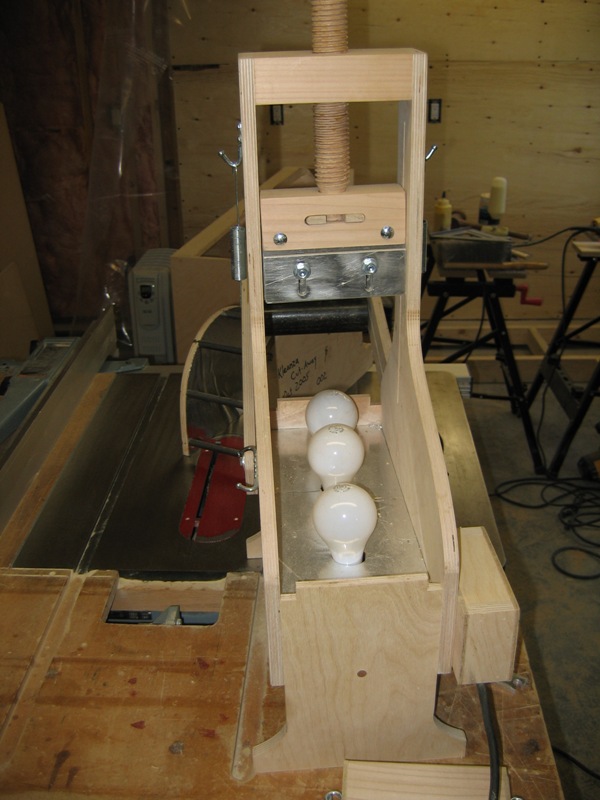

Anyway, here is the bender with 3 - 150 watt bulbs.
From the side. Note the timer switch, these are great but be cautious, they are not entirely reliable and you should never bend wood in this thing unattended.
Here is a typical form for this style of bender. You would use a steel slat under and over the wood, a wood sandwich!

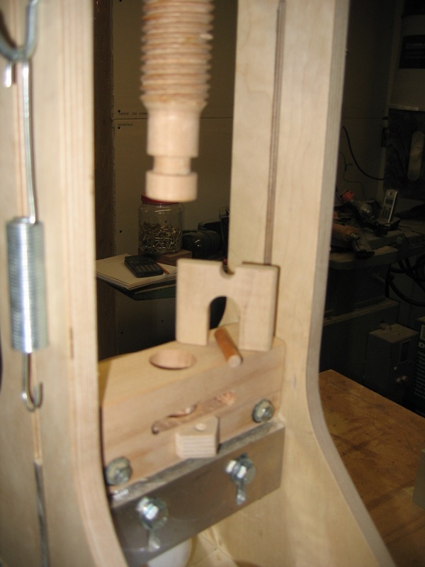

They make commercial screws that can be applied to these things, LMI sells them and so does Lee Valley. I made wood ones just for the fun of it. If you decide to be crazy as I was, here is how the caul seperated from the screw, hopefully you can put it back together in your mind.
My current (and only build) was bent on this machine with these bulbs and turned out great. BUT, I have a blanket now that I need to wire up and I think I will be building solid forms and will add another blanket so that I am heating both sides of the wood.
I hope these pics help those of you who are going down this road.

Nice wood threads. Did you cut them with a Beall threader?
PostPosted: Mon Nov 27, 2006 9:06 am
I did Marc, after spinning maple into a cylinder on the lathe. Then I did the caul connection area on the lathe as well. Way simpler to just buy a press thread. But I wanted to try this and it works well.

My thoughts are that the area inside sort of acts like an oven. The whole area heats up. I know that some people use 200 watt bulbs in the upper bout area and 150 watts in the in rest of the area (our 200 watts everywhere, or 150 and 100's). Using 3 - 150 watt bulbs I was actually very surprised at how easily my .085 aussie blackwood sides bent, even in the cutaway (which I had to bend twice becasue of a kink that occurred in the lower slat!). Having said this, I am going the blanket route and solid forms so that I can WYSIWYG the bend from the top! I will still use the bender though just different forms.

Could you continue to use the bulbs underneath and just use a blanket on top of the wood?
PostPosted: Mon Nov 27, 2006 11:40 am
HEY GRAHAM! How are you maiking out in the far cold north? My brother-in-law is up there also....I could ask if you know him or his wife (who is an engineer there also) but I think there are about 60,000 people so taht would be fruitless!!
I digress!! Nope, This is how the bender is set up now. I just used bulbs with it. I am about to take the bulbs out and switch to blankets, just because I want to go to a solid form rather than the ladder style form you see here. I will post pics in a couple of months when I get to that point. Building benches and cutting wood right now so this stuff is on hold.
