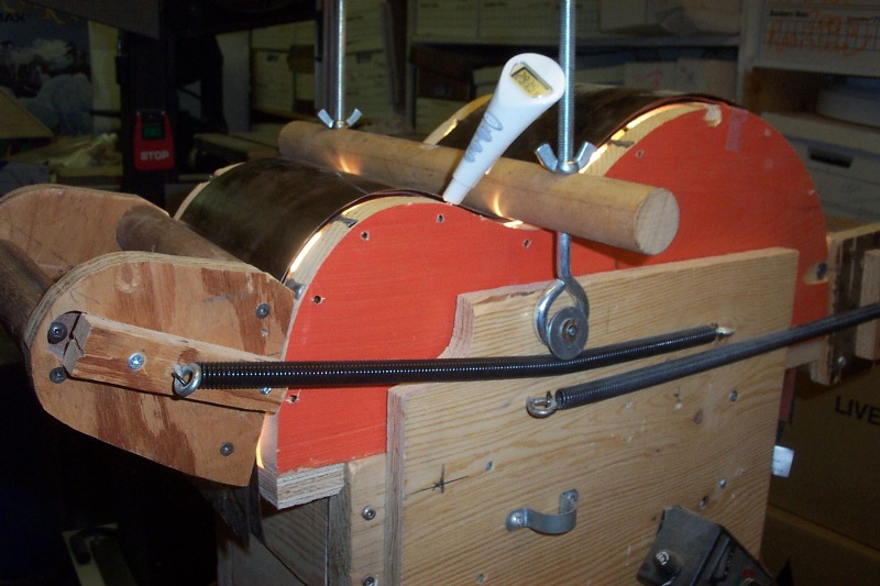

Chris, i wish i could post the link of the one made by Jc Jones, i built one like him, i use 3-200 watts bulbs and a heat blanket and also, i love the fact that i can use whatever shape/mold with it since the upper part is retractable or rather interchangeable so if you want to work on different projects at the same time, it would be very helpful!
Here's a pic with the SJ shape but i have bent dreadnaught size with a different mold
and another one with the dread's bending mold on
Hope it helps

I like to keep things simple, and especially on figured woods I like to get the feel of the wood bending in my hands. I guess it's a hangover from bending on a pipe. This is my bender, I just make a new one for each body shape. Blanket and slats from John Hall (110V so I have to transform). So for me no springs or big tower screws, I like to smooth mine down by hand or roll it round with the piece of broom handle, so I can feel the wood relax.
