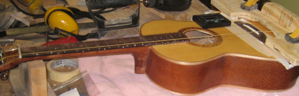

I saw this jig on OLF the other day and thought it was the coolest. Built my own and used it for 2 bridge sets. It aligns and intonates in one step. Slider behind the jig has holes set to the saddle width ( plus the extra for the longer distance). Move it side to side to align. Move the bridge and saddle forwrd or back depending on intonation. I use high and low E only. Once satisfied,drill two register holes through the string holes on the bridge. Pin with the gluing bridge pins which do not stick to glue (StewMac). Take thi jig off, remove the finish, glue and clamp. I could not believe how simple this step could be.
