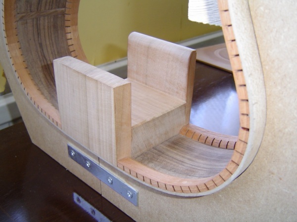

I'm currently building an OM with a cherry neck and also head and tailblock. Russell Rose another of the UK builders uses Cherry a lot as well.

I like your laminated block Colin, kinda what I had in mind.
