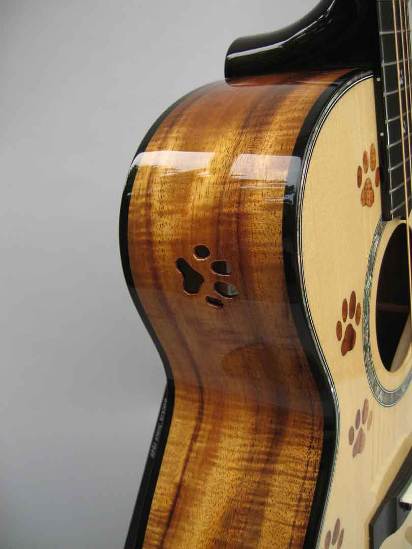

PostPosted: Sat Dec 09, 2006 5:31 pm
Soundports are kind of nice. They come in all forms.
here is one of mine.
PostPosted: Sun Dec 10, 2006 12:42 am
Andy, did you reinforce the paw on the inside?

Lillian
Yes, there is a thin veneer of ebony
