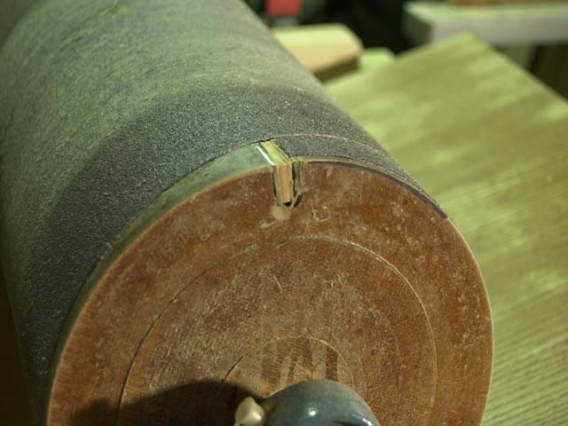

Using a softwood wedge in a slot in the drum was a technique from a thickness sander 'kit' (LMI??) I built about 20 yrs ago. It's effective and less cumbersome than hose clamps and screws.

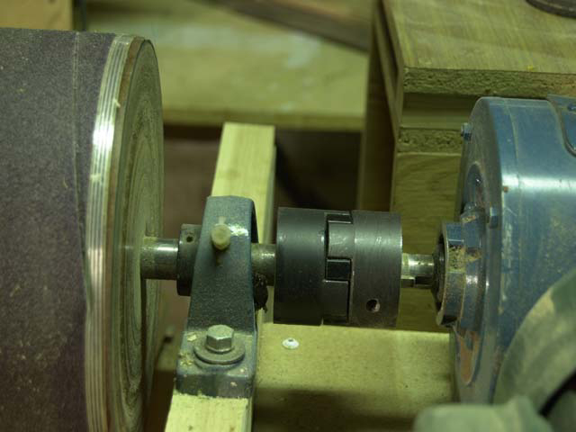

Direct drive eliminates a lot of messing with belts and pulleys. If you are building a smaller sander, you can make it a 'tabletop' model using direct drive. This is a commercial flex coupling; on my first sander I used a chunk of heater hose and hose clamps. Both work.

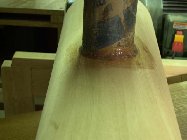

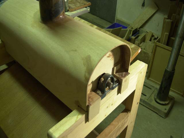

Using epoxy and filleting blend makes an easy job of joining curves. The 'pipe' for the dust collector hose is a section of shipping tube, but epoxy sticks well to ABS and PVC as well (roughen before bonding).
This curved hood looks effective, but I've lost my handy spot to stack work in progress. The old 'flat-top' on my previous sander was better.

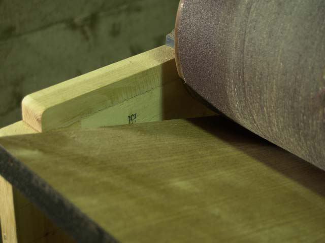

Having the 'table' sloped at the most common thicknessing position helps coarse sawdust make its way to the floor, rather than accumulating.

Cool! Thanks for posting! Is your drum phenolic?

The drum looks to be ali with phenolic end caps, what ever it does look to be a very affective machine.

[QUOTE=Billy T] Cool! Thanks for posting! Is your drum phenolic?[/QUOTE]
I'm too cheap to use stuff like phenolic for a drum sander!
The drum is made of stacked disks of veneered particleboard and lumber-core plywood. When I decided to get back to guitar building I went to an auction and picked up some old case-type furniture (desks and such) for $2 and $5 and knocked them apart for the lumber. Great for workboards, etc. as well as tools like this.
I think the end disks have mahogany veneer/mahog plywood. I trued up the ends with a turning tool once I had the drum spinning- not necessary but it looks a bit better.

Very nice machine John and thanks for the "wedge in a slot " tip, i'll probably switch to that instead of carpet tape!
