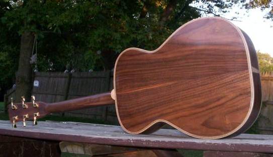

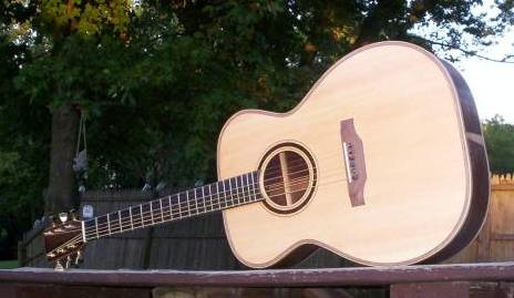

FWIW, I used walnut as the primary woods on my first OM, and although time will tell, the results were a nice looking and sounding guitar.
The back and sides, neck, headstock, rosette, and bridge are all walnut.
