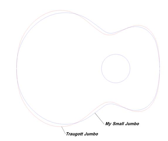

PostPosted: Wed Dec 13, 2006 4:44 am
I am working on drawings for a 16 1/4" jumbo based off of Traugott's jumbo shape but reduced to 16 1/4" LB all I have is the shape profile at present but would be willing to share.
lg 20"
LB 16 1/4"
UB 12"
depth at butt 4 5/8"
depth at neck 3 5/8"

I am not surching. I was offering a shape profile of a jumbo larger than an SJ and smaller than a J-200 with roughly the basic shape of the J-200 (big round curves) I have the shape that I am developing for a client. It is based on the Traugott jumbo but 1/4" smaller LB.
But thanks anyway
PostPosted: Wed Dec 13, 2006 8:23 am
Here is a relationship pic of the 16 1/4" Traugott jumbo to the OLF SJ
