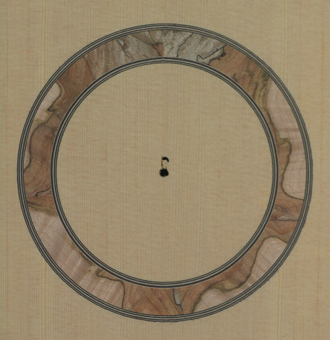

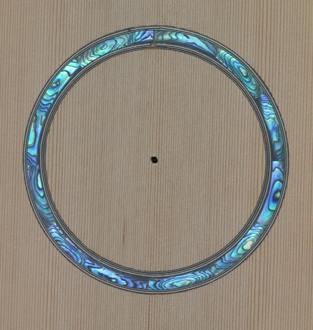

Here are a couple rosettes I just completed. They should look better under finish.
The first is a Michael Collins inspired. I couldn't quite make one with his flare for design but I think it looks pretty good. Thank you Michael It is on a SJ sitka top and will have EIR back & sides
This one is Andy Depauls great paua rosettes. It also should look better under finish. It is a cedar top going on sapele B&S.

Very nice, Joe. Is that abalone 3/8"?

It's 1/4", but it does look pretty big in the top. Should show off well.
Steve,
DePaul is great, I ordered a Paua rosette from LMI last year and I'm sorry to say, there is no comparison. (Sorry LMI but please know I do love you. You have made me happy time and again through the years!!!

I starting doing it just like Michael Collins described a month or so ago. I had two problems, my spalded maple was to busy so after all the work bookmatching I might of just as well cut out one piece! The other was I tried to use CA to join the pieces together but the joints showed. The system Michael uses works well if you select your wood well and use LMI white glue...nice joints.
The way I did this one was a little wasteful but it worked. I took an inch and a quarter piece of maple burl, used a circle cutter on my trim router with a down cut end mill and cut an outline of about a 3 inch segment of the rosette. I picked a piece with a nice pattern. I cut about 3/4 way through the board. Then I set my bandsaw at about .1" and cut some slices.
The rosette in the picture is made of about 5 pieces, no set size, I just cut the lenghts I needed to make a nice pattern. I made a jig with the router and circle cutter to trim the pieces to lenght. Kind of like Michaels except I used a rasor saw and not a sanding disk for trimming, Glued with LMI white, inlayed the rosette and the used the router to trim around and make a channel for the purfuring.
