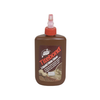

I've seen quite a bit of discussion about Hot Hide Glue, and I've been wondering if any of you guys have seen or used Titebonds Liquid Hide Glue;
Is it comparable to HHG?

NO!!!
PostPosted: Wed Dec 13, 2006 2:00 pm
NO!!!!
NO!!!!!
PostPosted: Wed Dec 13, 2006 2:02 pm
Ya gotta get a pot and ya gotta get some granulated hide glue and ya gotta cook it up. You don't want to use that titebond liquid stuff on a guitar.John How39064.9186805556

You can glue on your labels with it, maybe even a rosette or other non-stressed part, but for brace/body/bridge/etc assembly...get the heating pot out.

sometimes it won't cure at all. when first i saw some i used it to glue some inlay paterns to pearl blanks. it never really hardened off, and made it impossible to saw; just clogged the blade.
don't waste your money.

I've tryed it and I found just like Michael, it didn't ever set up or harden. It was a mess and just didn't work at all.
Don't know why they keep making it, someone must use it for something
