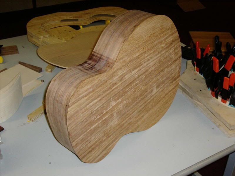

Just a reminder.... that's it on the left.........
I'd just rigged a hot pipe to bend on and had tried a set of maple for a mandonaught, then I thought..... "Why not?" and started into the granadillo.
My bending experience is VERY limited. I've bent a set of EIR and some maple, so I'm not a master......
What I can say, is that this stuff takes AGES and a load of heat to start to "give". I'd planed it to the same thickness as the maple sides (as low as the planer/thicknesser will go) and the maple was FAR easier to bend.
There was a little of the grain letting go on the outside of the curves too. not cracking as such, just a few bits that'll need CAed back down again.
Ok yes, it's as splitery as splintery stuff!! I spent half a night with a needle retrieving all the bits from my hands..........
still, I do like the look of it, and it'll eventually be a guitar for a friend, topped by the lump of cedar laying on top of it here.........
Yes I know that there are some gluey drips on the inside, but none on the outside yet!!!!
Thanks Hibdon, I couldn't have got here without you!!!!!

Did you measure the thickness of the sides prior to bending? I would not even try to bend granadillo at anything more than 2mm (.080")

The sides are 2.7mm
If my hassles (wouldn't strech to calling them problems!!) help some other noob like me then all the better!!

Martin - Nice job! I'm impressed you were able to bend this stuff by hand at 2.7mm. When I get around to it, I'm going for 1.8mm.
I am wondering though, how long did you let the wood acclimate to your shop before using it? This isn't the wood from the Hibdon promotion is it?

yup it's the stuff from the promo. I reckoned that as I was gonna soak it and cook it, why'd I wanna leave it to reach the same humidity as my school workshop first?
top is cedar (in the pic!!)
As to levitating, I work so fast that gravity hasn't got a chance!!!.... think Ronnie Soak in Terry Pratchet's "thief of time"..... (Sam'll get that, the rest of you?)
as to the thickness, we just got a thicknesser/planer in school.....I fed it through til it was as thin as the machine would take it. the same as the mahogany that two pupils are putting on top of arched mantle clocks they're making and the maple that I bent first. As Granadillo isn't that common (the reason for Hibdon's generous offer in the first place) I didn't know that it was tougher to bend than tough stuff.....
