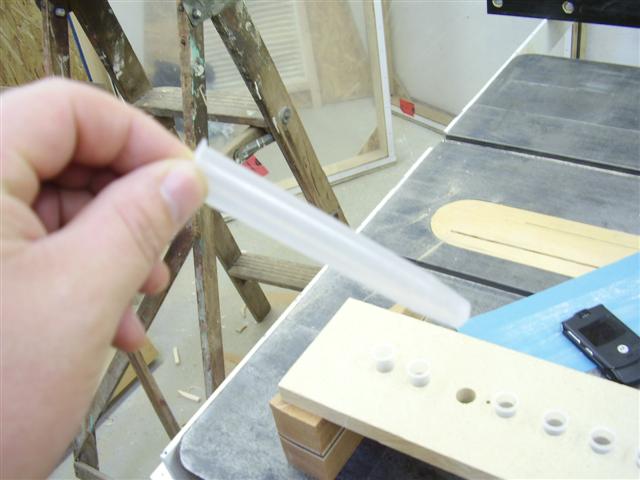

We we got home and were putting the roses in a vase, I was looking at those little tubes that they put the stems in so they stay hydrated.
Well, I was looking at them, thinking, "those might be good for freezing hide glue" They come with the little cap and I thought, you could just put 4 layers of plastic over the top and it would seal good.

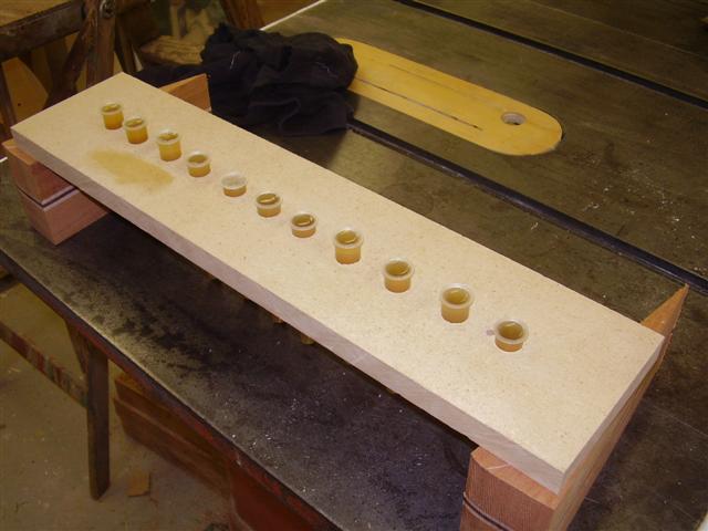

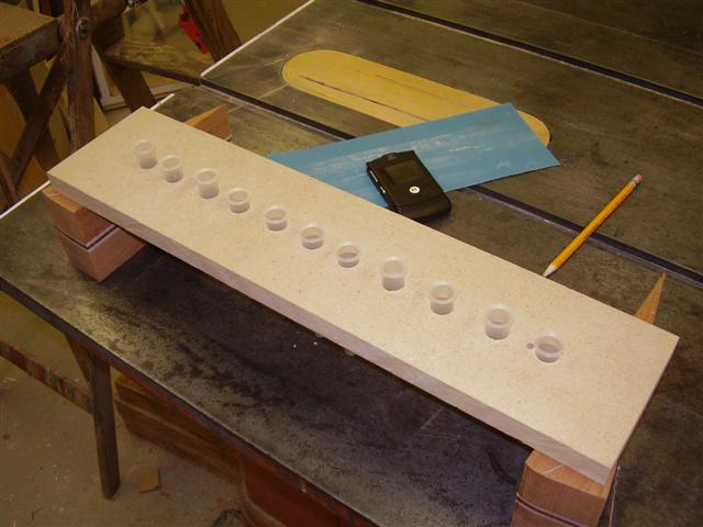

First I cleaned out the tube. Than I made a board to hold the tubes while filling and letting the glue gel.

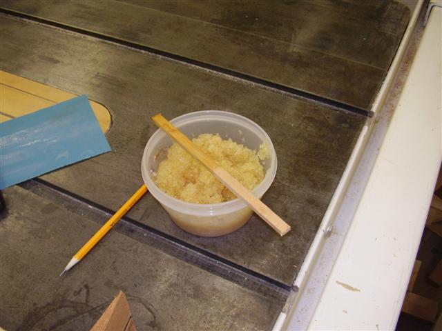

While I was doing this, the glue was soaking up the water and getting ready to cook.
Once the glue was all dissolved and cooked, I poured it into the tubes and let it sit to gel.

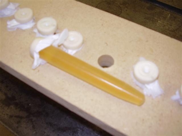

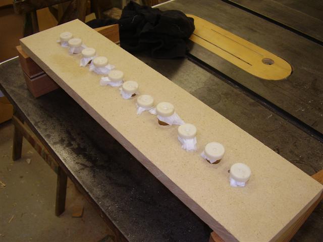

That was in the afternoon, so this evening when the glue had gelled, I cut up some pieces of plastic (4 total as the covering) and placed the little cap over top.
Next into the freezer they go till I need some more glue. If I need a little, I'll take one tube and it will give me about 3/4 oz of glue. I can pop them out of the tube and put them in my little 3 oz bottle, or just heat up the tube and pour it into the little bottle.

Seem like, with all that water in the mixture, there might be enough expansion to burst those tubes as it freezes, or at least pop the tops off. Might need to reseal the tops after it freezes.
May need to put them in a zip lock bag to prevent freezer burn.

I was wondering about that as well Ron. I just checked them and none of them have burst and only a couple have even raised the cap, but didn't pop them off. I made sure not to fill right to the top, rather leave a little (very little infact) room for some expansion. Seems to be ok.
I may take them out of the tube and double freezer bag them like Colin.
