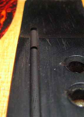

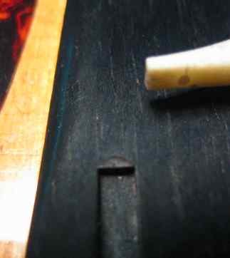

First, Martin is no longer using a true through saddle. The slot is actually
closed on the ends, with the end of the cut filled with an ebony filler to
give the appearance of the square end of a true through saddle.

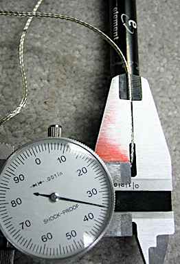

Next decide how deep the pickup recess has to be. The Element measures
out at about .035", and will compress down to around .033" with my
calipers.

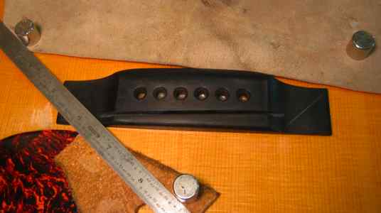

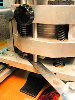

Still having my saddle routing tool setup undisturbed from the last cut, I
will set the depth stop for .032" deeper than the initial clean up cut.
Here is the recess cut in. I routed it slightly longer than a standard
saddle.

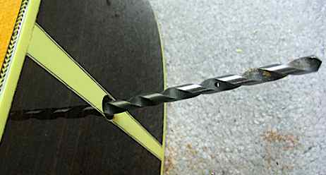

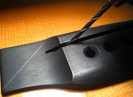

Now to drill the access hole in the bottom of the slot, I always like to see
where the braces are. A couple of magnets and a ruler make this easy.
Coaxial, ribbon and film transducers don't like the 90 degree hole that
traditional piezo's use. I noticed when I got home that in my posing for
this shot I exagerated the angle, but you get the idea. Somewhere in the
range of 60-65 degrees above the slot should be sufficient.
Then I still like to go in with a micro chisel and soften the angle that it
will have to bend at as it leaves the slot.
Here's how it will fit.

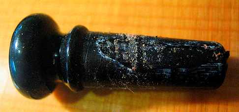

Then the cussing begins as I try to remove the end pin to ream out the
hole. PLEASE DO NOT GLUE IN THE END PIN!
It is a taper fit pin and is designed to be removable.
NEVER GLUE IN THE END PIN! Thank you...

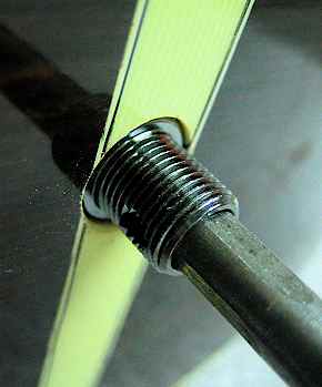

With the hole reamed I will make a quick note on how I like jacks
installed. Leave then not tight enough and they will come loose, and wires
will twist and break as the player tries to tighten it up by spinning the
end. Too tight and the finish will crack and lift - I've even seen end wedge
binding puckered out from the force. First get yourself an 18"-24" pice of
1/4" rod. I use my 18" 1/4" drill bit. This makes is simple and painless to
install and remove the jack as many times as necessary to get the
tightness right.
I like to set it so that when the nut is moderately tight it will bottom out
on the larger diameter of the jack. This way the washer doesn't flare
inward and crack the finish as I see so often. I can also then tighten the
nut more aggresively on the the jack to keep it from coming loose, still
without increasing the pressure against the body or finish. Start by
leaving the face of the large diameter of the jack set about 1/32" below
the surface of the finish. This will usually be pretty close, but keep pulling
it back out and adjusting the inner nut(s) until it feels right. I know I seem
picky about this, but improperly tightened jacks cause problems that I see
very often.

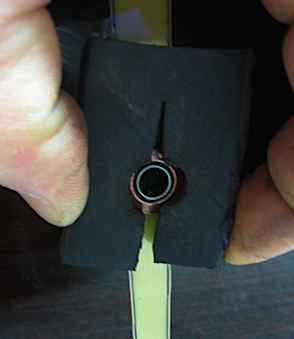

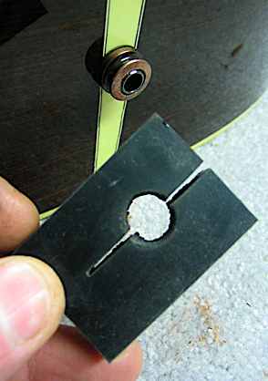

Finger tightened strap button ends that are chronically coming loose are
another common problem. The other side of that would be buttons
marred with plier marks, or even worse, Loctite or super glue. A simple
non-marking wrench is easy to make. For this tool I just drilled a hole
and cut a slot in a piece of 1/2" rubber.
Here it is in use - pretty fancy engineering, eh?

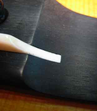

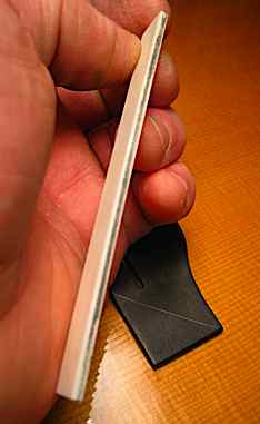

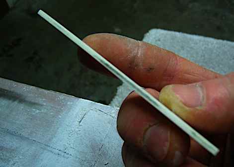

Okay, enough time on jack philosophy. On to the saddle. Always flatten
the bottom of your saddles on a surface block, float glass, or something
reasonably flat, especially after you have sanded the bottom on a belt
sander. When a saddle is sanded aggresively the surface will heat and cup
away from that side, leaving the center bowed out to be sanded more
than the edges. After the saddle cools, mark the base with a pencil and
sand it lightly on a block.
Here it is after a few strokes. It will look like this ever single time, whether
you are using bone, tusq, graphtech, etc.

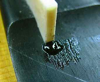

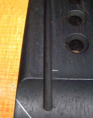

After fitting the thickness and length it's time for me to refill the ends of
the slot. Normally this could be done after the saddle is shaped, but for
various reasons I needed the fills to be dried the following day and was

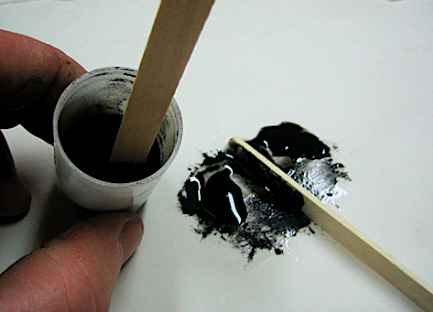

not going to have time to shape the saddle that day. I'll be using an epoxy
filled with ebony dust, although I'm sure there are black wood fillers that
would work just fine as well. First I wax the saddle to keep it from being
glued.
Mix some ebony dust with a small batch of my West System epoxy. It's
amazing how much this stuff absorbs. Whenever I add filler it seems I
have to add 2-3 times the volume of the glue in filler before it really
thickens.
Then fill the ends of the slot, custome molded to the saddle ends. I'm
doing this with the pickup out of the slot by the way. I want the saddle
fitting as tight to the sides and bottom to prevent epoxy from flowing in
to the slot.

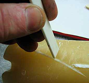

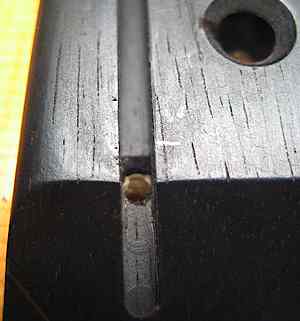

Next day, trim the exess epoxy with a chisel and remove the saddle.
Then go about the usual business of making a saddle, file and sand the
saddle flush to the bridge at the ends, buff out the saddle and bridge.

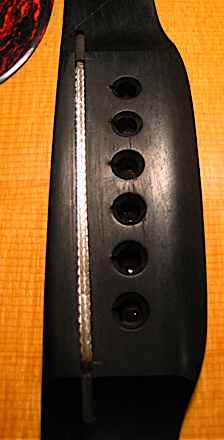

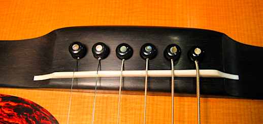

After checking the pickup balance and having everything complete, I
decided to very lightly glue the ends of this saddle in. They are usually
glued in anyway, and this style of pickup leaves itself prone to moving if
the saddle were removed. This is not usually a problem on closed end
saddles, but just as a precaution I decided to rub some glue in the the
very ends to hold it in place.
Clean it up and here it is.
It's not something I do often, but this customer really wanted this
particular pickup in his guitar, and had been told by others that it was not
possible. I would have probably recommended against the extra expense
in most cases, but since I was already doing a bridge reglue, fret work
and a new bone saddle here some of the extra work would cross over. It
sounds just like it does in a standard bridge.
